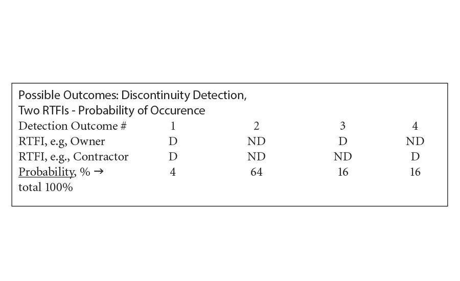

The following radiographic interpretation outcomes are derived from a simple probability analysis of two RTFIs, for example, one each from the owner and contractor, respectively, each performing interpretations on the same radiographic image A key premise in this analysis is that the two interpreters are fully qualified and perform their interpretations in a statistically independent manner. In other words, the interpretation by one interpreter has no effect on the interpretation performed by the other interpreter. Thus,  there are four possible detection outcomes when these two RTFIs interpret the same radiograph: (see Table 1.)
Where D = the RTFI detects that a discontinuity exists
ND = the RTFI does not detect that a discontinuity exists
In outcomes #1 and #2, the RTFIs from the owner and contractor reach the same conclusions: both see a discontinuity in outcome #1 and both do not see a discontinuity in outcome #2. In outcomes #3 and #4, one RTFI sees a discontinuity while the other does not.

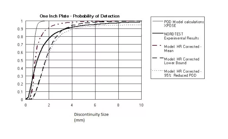

The POD graphs developed for radiography provide a basis for estimating the interpretation variances to be expected when two independent RTFIs view a radiograph. To provide an example POD graph only on which to apply the simple probability exercise, the following Graph 1 was extracted from work done by NORDTEST on radiographic NDE, which incorporates experimental and XPOSE model data plus human reliability (HR) results.ix
Graph 1. Example POD Graph
The focus was on examining the NORDTEST experimental results solid line, again only for illustrating the probability technique to be applied. Readers are referred to the original paper for details on the radiographic technique and data analysis used in the construction of this Graph.  In practice, readers can access and effectively use any graph derived and constructed from a POD analysis provided that derivation/construction is statistically valid. For illustration purposes, we consider a required radiographic quality level or sensitivity of 2% for the 25.4mm (1 inch) steel plate in Graph 1. In applying a 2% sensitivity level, owners typically select a 2-2T hole requirement when hole type image quality indicators (IQIs) are used or their equivalent, essential wire when wire-type IQIs are used. This 2% sensitivity is the default value contained in the American Society for Testing & Materials (ASTM) Standard E-1742 and ASME SE-94.x ASME Section Vxi defines the 2T hole image in a 2% shim type IQI as the essential image for establishing acceptable quality level unless another level of sensitivity is stipulated in the contract. A 2% sensitivity is a typical level applied in examining pipe welds within the petroleum industry. Note that this sensitivity relates to the smallest discernible detail seen by the RTFI on the radiographic image, not the minimum size discontinuity present in the part being radiographed. The 2% sensitivity applied to the 25.4mm (1in) plate yields an approximate 0.5mm (0.02in) ‘defect size’ (discontinuity), per Graph 1.  At 0.5mm, the POD is approximately 0.2, or 20%, using, for illustration purposes, the ‘Nordtest Experimental Results’ line. Thus, there is a 20% probability that a given RTFI will ‘see’ or detect this discontinuity and 80% probability that he will not see it. The probability of occurrence of two independent events, in our case image interpretation results, is the product of the individual probabilities of each event.xii

Therefore, the probabilities that two RTFIs, say one for the owner and one for the contractor, either will ‘see’, or detect, this discontinuity is 0.2 x 0.2 or 0.04 or 4%. This scenario corresponds to detection outcome #1 in Table 1. The probabilities for the other three detection outcomes are calculated similarly, by multiplying the detection probabilities of each individual interpreter in each detection outcome case.
Thus, the probabilities of the various detection outcomes are: (See Table 2.)
In outcomes #1 and #2, the interpretations of the owner and contractor RTFIs agree, although the probability of non-detection by both the RTFIs is significantly greater than detection because of the relatively small ‘defect’ size.  Outcomes #3 and #4, which comprise the variance or disagreement cases between the respective RTFIs, total to a 32% probability of disagreement. Thus there is a significant probability, 32%, of disagreement between qualified RTFIs when interpreting radiographs in this particular 25.4mm steel plate, 2% sensitivity case. This equates to an expected 68% (Outcomes #1 + 2: 4% + 64%) agreement between RTFIs.

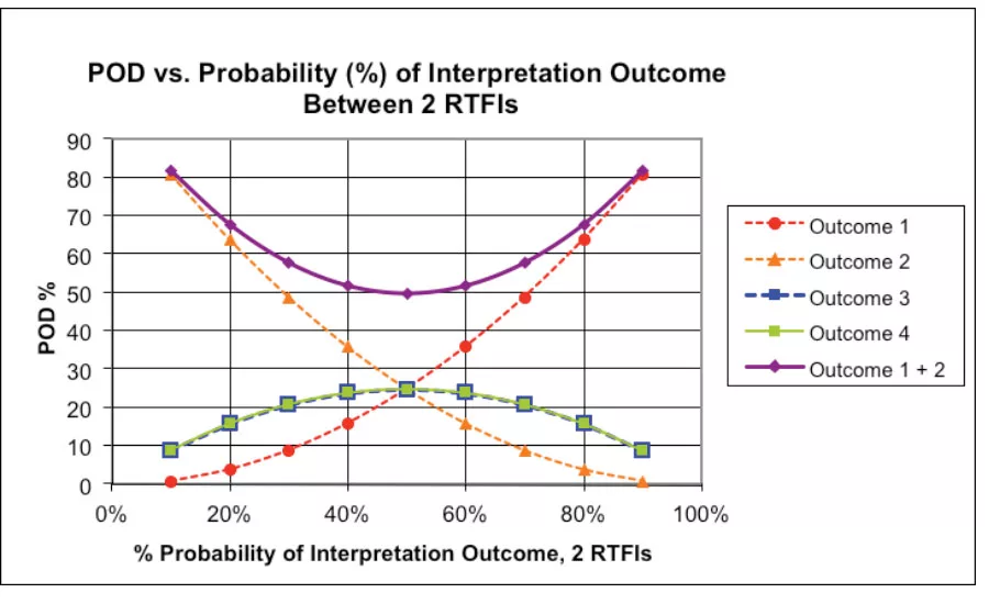

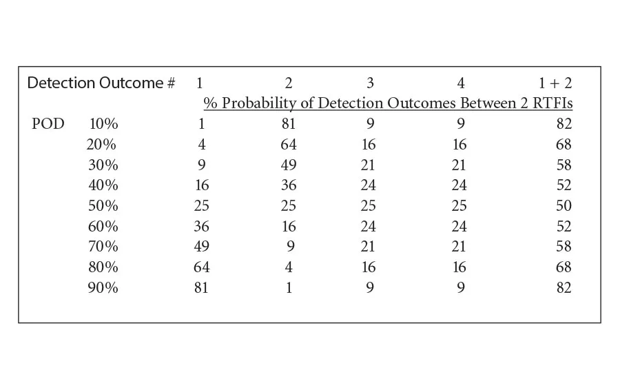

The following table provides a simple, generalized correlation between the POD percentages and the expected percentages of the detection outcome possibilities between two RTFIs for this specific, example POD graph shown inTable 3.
Per the ‘% Probability of Detection Outcome’ columns, the conclusions are that the smallest and largest ‘discontinuity’ sizes, corresponding to the lowest and highest PODs respectively, similarly correspond to the highest levels of detection or non-detection agreement between RTFIs. It intuitively might be expected that, in practice, owner and contractor RTFIs would disagree predominantly in their decisions or interpretations on the smallest ‘discontinuities’. However, probability shows that they mostly will reach, independently, a ‘false negative’ conclusion (64% agreement on ‘ND’) in that instance and agree that ‘no discontinuity’ is present.xiii Fortunately, this ‘consensus’ false negative occurs predominantly on the smallest discontinuities – left hand side of the graph and lower POD values in column 2 above - which, in general, provide less threat to the integrity of the weld in question. The data appears in graphical form in Graph 2.
