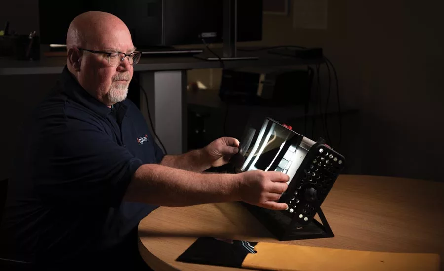

radiographer
A qualified radiographer will maximize each variable in order to achieve the highest quality image even though the ideal technique may require additional time. Photo credit: Doug Miskell, ApplusRTD. Photo courtesy of Full Circle Studios LLC
