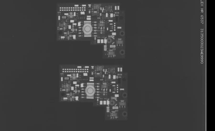

pcb-board
Printed circuit boards can be examined quickly and accurately using a computed radiography systems. Source: Laboratory Testing

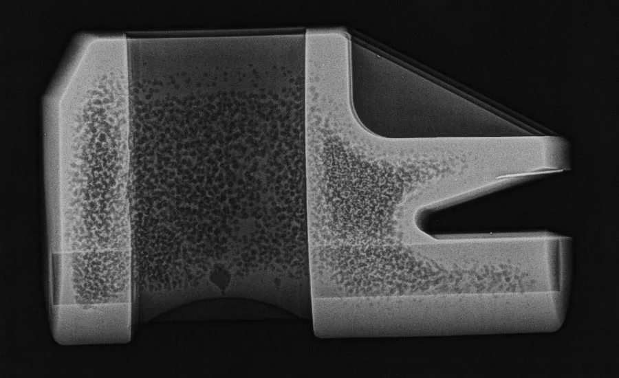

plastic-with-gas-and-foreign-material-inclusion
Computed Radiography permits for great viewing latitude allowing you to capture in one exposure what may take multiple exposures and speeds using a film method. Source: Laboratory Testing

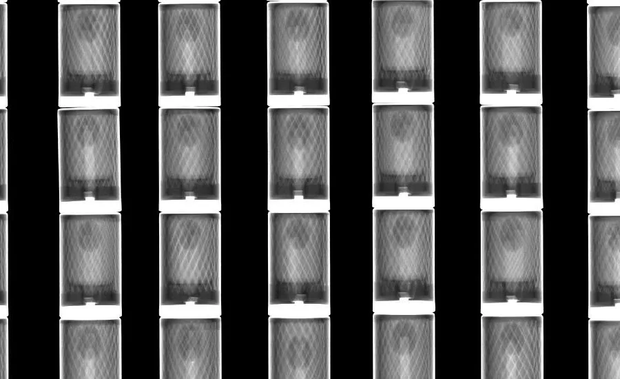

sealed-housing

Discontinuities within plastic injection moldings stand out from the lot using radiographic inspection. Multiple samples can be exposed at once making this both a cost effective and reliable examination. Source: Laboratory Testing

Individuals or companies involved in the manufacturing of transformers, transceivers, delay lines or semiconductors find radiographic inspection a useful tool in showing their customer that any given sample is completely free of foreign debris inside of its casing. This assurance provides confidence as it helps to eliminate risks of any possibility of shorts and provides a comprehensive layout of the part’s internals. Results can be independently generated to validate traceability and prevent human intervention. In this industry, computed radiography is especially useful as its process provides the manufacturer and their client with images that can be efficiently transferred and shared, if required.

With all of the new advances of plastics noted in recent years, the demand for custom injection moldings is more prevalent. Injection molding of samples is a widely used method of producing high volumes of identical components. Tight tolerance applications leave no room for defects or abnormalities in the samples. Radiographic inspection is useful for these molds as it provides a cost effective, non-invasive way to identify voids and assure one hundred percent compliance of the component. In turn, the inspection prevents the need for any destructive testing or scrapping after or during further value added services, such as cutting, machining or assembling. In a similar situation, manufacturers can purge and quarantine material samples before and after mold runs. These specimens can be examined and fully checked for foreign material within specific lots. Both computed radiography and conventional film-based radiography may be utilized here depending on requirements.
