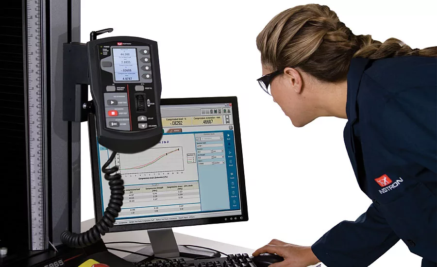

A major benefit of retrofits is the common user interface shared with new testing systems. Source: Instron

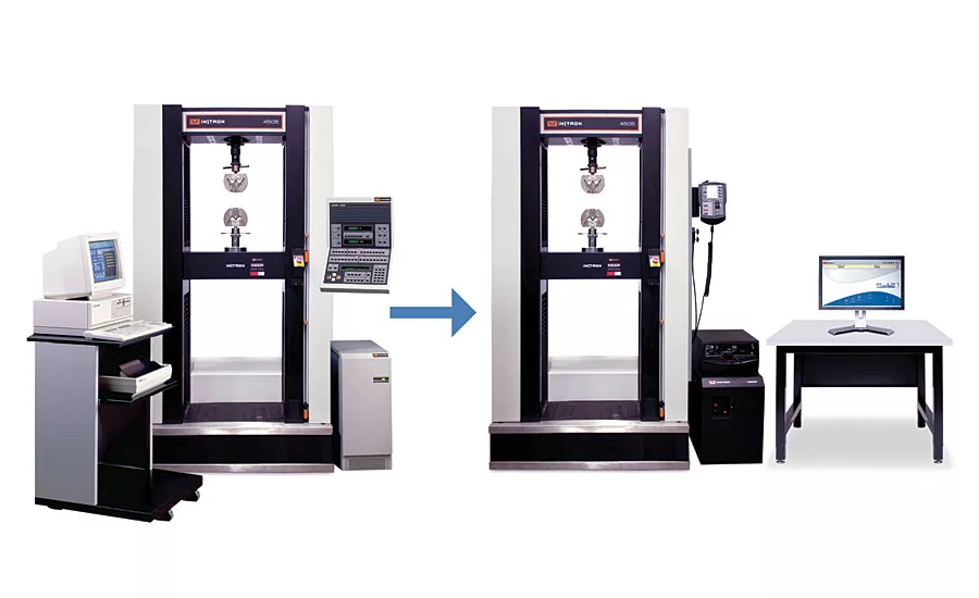

This is an example of an Instron Model 4505 produced 25 years ago retrofitted with new electronics, control panel, and software, completed in one day at a customer site. Source: Instron

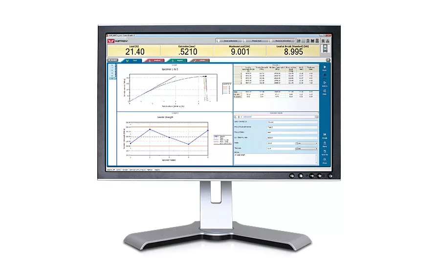

Older testing systems can now use the latest software to display test curves, calculated results, video capture of test, and data points. Source: Instron

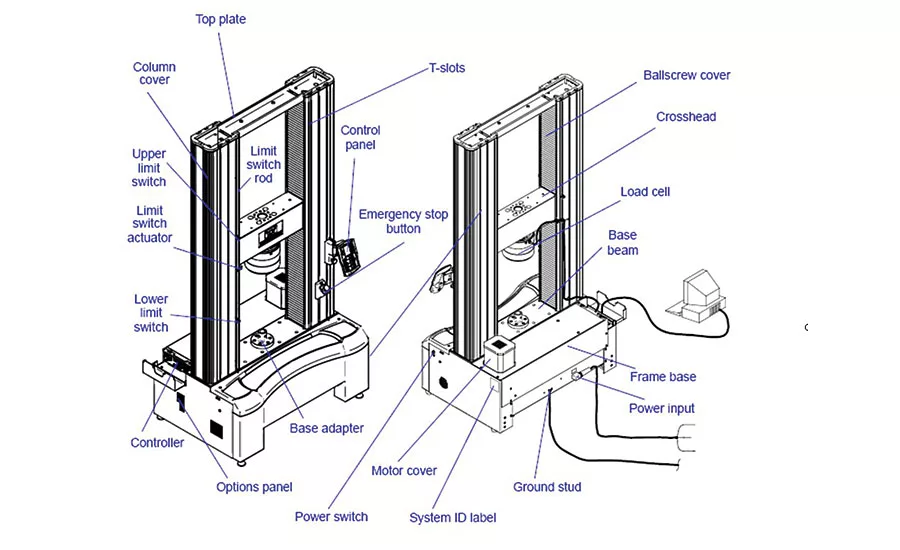

Components of a Universal Testing System. Source: Instron

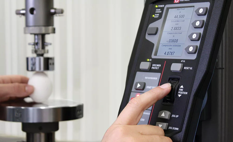

An Instron 5900 retrofit control panel with LCD live displays and controls is shown here. Source: Instron

UTMs have been in existence for more than 80 years, with the most common being electromechanical testing systems. Used for performing tensile, compression, flexural (bending), and component tests, the design of these systems can be separated into two major parts: the frame and the controller.
The testing frame is the bulk of the mechanical portion of the system. The load frame typically has twin columns with rotating lead screws, which move a crosshead vertically up and down. More robust systems include guide columns to provide structural stiffness and improve alignment. The load transducer (load cell) is attached to the moving crosshead or base. Grips, platens, or other fixtures are attached to both the load cell and the base to complete the test load string. An encoder is typically used to read the distance that the moving crosshead travels during the test. Other transducers, such as extensometers or LVDTs, may also be used to measure the actual displacement for the specimen or component being tested.
The controller can be considered the “brains” of the system. The controller is responsible for monitoring and controlling the frame and transducers in conjunction with other accessories such as temperature chambers and furnaces. A controller may also be coupled with a computer for control with predefined test methods, data collection, analysis, and reporting.
