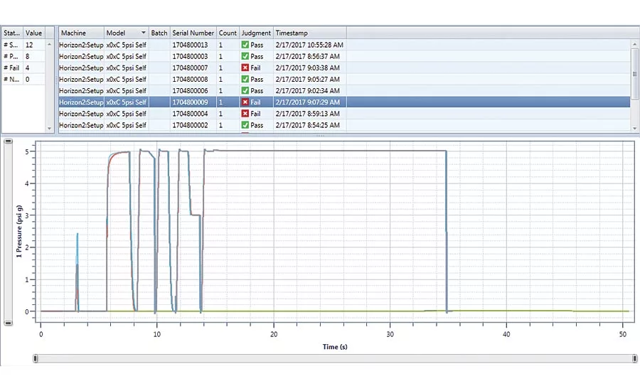

Start by collecting the full waveform
Every single manufacturing test or process generates a digital process signature that can be recorded, interpreted and visualized. A single signature can contain hundreds and even thousands of data points.
By equipping a manufacturing process, or a test station like leak, with appropriate sensors such as temperature, flow and pressure sensors, highly consistent and repeatable signals can be obtained that directly indicate the consistency and quality of the process or product.
Once you have captured the digital process signatures, they can be analyzed, overlaid and compared. In its most simple form, signature analysis is the comparison of a specific process response or waveform against an acceptable pre-determined response. This is crucial to improve Gage R.

Verify the system
This test checks the overall health of the test station including the leak tester, part seals, fill ports, connection hoses and pressure sensors. All part seals and fill ports are connected to a verification tool, typically a machined manifold that simulates all connections to the test part. This verifies there are no leaking seals or hoses and that any leak measured in a part is correct. If a leak is measured, seals can then be individually checked to find the failure.
Records of each system verification and individual seal test should be stored alongside the rest of the signature data from the test station.

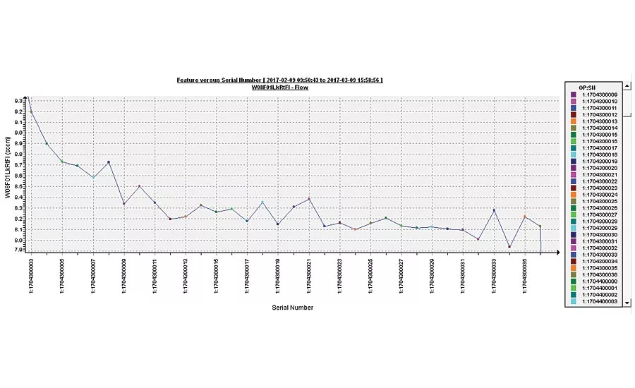

Consider the part’s temperature
Washes and baking processes can leave a part warmer than the ambient air. Warmer parts don’t allow heat to leave the air in the part and consequently show a higher leak rate. Filling the part also warms it up, possibly giving a false fail on a retest if sufficient relax time is not given. Once you have Gage R dialed in, go back and look at how this variable can be either compensated for or eliminated during regular production.
Clamp, test, repeat… repeatedly
To avoid introducing variables, it’s important to clamp the part once and leave it there while running the test repeatedly.
Remember we are just referring to the first “R.” Our approach is to run the test 40 times and drop from the data the first few runs as the system stabilizes. This ensures that the temperature increase and decrease of the part is the same between runs, eliminating test-induced thermal loading. Additionally, we typically test with extended cycle times, to judge if performance improvements or desired results require additional test time.

Let’s say your target Gage R is 20% and we find that it is already better than that at 18%. But looking at the data, we see that if we add five seconds to the test cycle to help with temperature/pressure stabilization, we can cut Gage R down to 10%. This now leaves us with a 10% window to counter the second “R” variables, like how the part is clamped test to test and other operator behaviors.
It’s now easy to play with the data for all manner of scenarios. Chart the impact of lengthening the test cycle (and adding a second parallel test station to keep up with production). Or, maintain the same overall cycle time, but change how that window is divided between the fill, stabilization and test phases. The ideal goal is to shorten cycle times while improving Gage R, as our studies are often able to accomplish.
