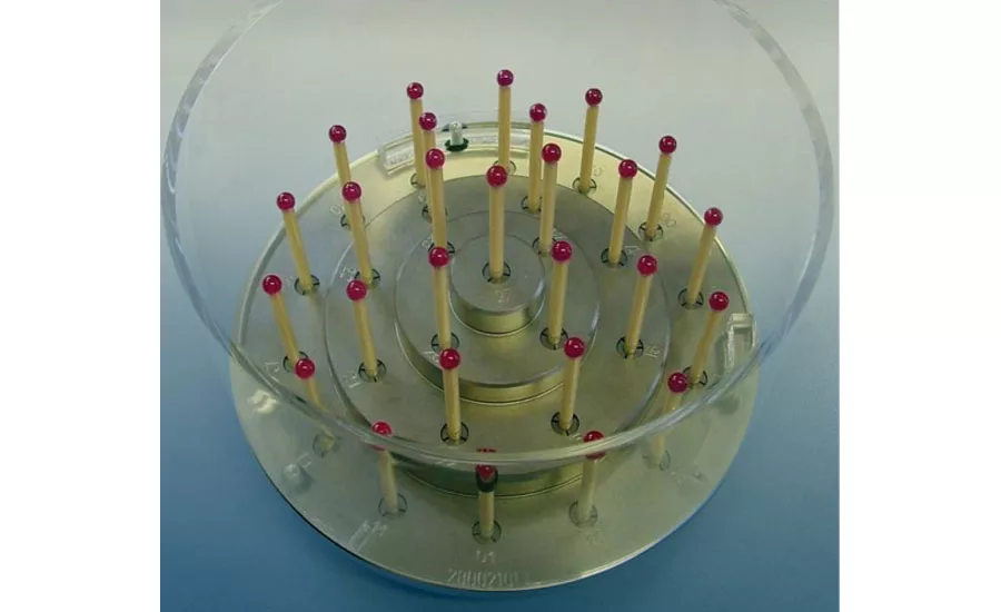

Currently the VDI-VDE 2630 specification is the only standardized method for evaluating the baseline performance (measurement uncertainty) of CT machines. It is typically used in combination with ISO 10360. The specification states that the CT manufacturers must use traceable dimensional gages to validate the measuring performance of CT machines. Unfortunately not all CT scanning systems on the market today comply with the standard. It is important to be aware of this if you are considering the purchase of a CT scanning system, or are outsourcing any dimensional inspection that requires certified accurate results.
Ask the CT manufacturer or service provider to show their MPEsd , MPEPF, MPEPS and MPEE values

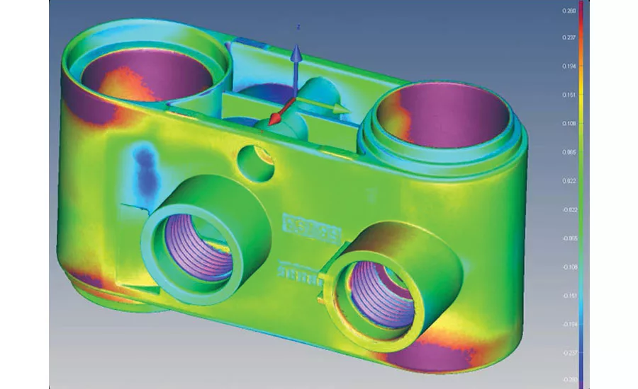

If the volume of work you produce that could utilize CT-CMM scanning does not justify the purchase of a machine, CT scanning services are available for dimensional inspection and flaw detection. Some manufacturers have multiple locations across the USA where the systems can be demonstrated, and/or contract services are available. Whoever you contract with, it’s fair to ask the provider what type of systems they are using, and if the work is being done in-house. Be sure to review the application with the service provider, and provide specific details about what your expectation is for the end result. This can help prevent a deliverable that does not meet your requirements. If the requirement is for dimensional inspection, a print with the features of interest highlighted helps clarify the scope of the project. If you have a solid model CAD for the part, this will allow a graphical “part to CAD” inspection report to be generated. A report like this provides a chromatic legend that displays how the part deviates from the nominal CAD data. These reports are very intuitive and allow the results to be more easily understood by a variety of staff and management.
The opening image is of a 3-D chromatic part to CAD inspection report. Note that the deviation from the CAD model is even displayed for the internal threads! The volume of the data set is so complete that it can simulate a functional gage like a thread gage, but even better since quantifiable dimensions are accessible.

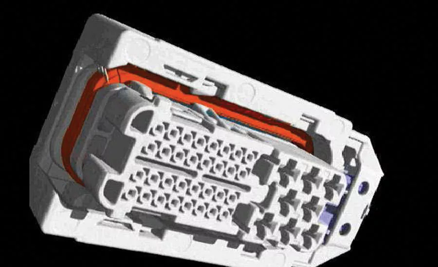

For parts with complex geometries and a multitude of features to be measured, inspection with a CT scanner can dramatically reduce the time to create and execute a part inspection program. This page also shows a 3-D CT image of an electrical connector. The CT scan captured the part geometry in its entirety, on both inner and outer features. No complex CNC program has to be written, and the part fixture can be as simple as a piece of foam cut to hold the part. Taking a measurement of a feature at a specified depth to account for a draft angle is no problem. Inspection points can be taken anywhere on the surface of the features.

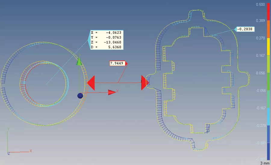

Images of the data file can also be sliced at exact locations for evaluation or for creating a 2-D profile plot. These 2-D plots with “whiskers” showing the deviation from nominal in a specific plane are very valuable for some applications. In addition to the graphical display, the feature dimensions can also be shown in text boxes that correspond to specific callouts on the part print.
