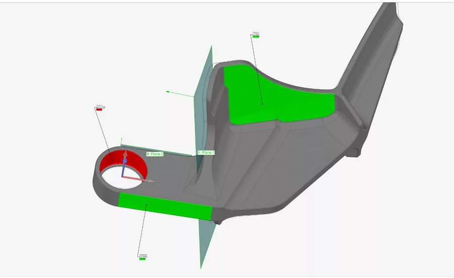

FAI using scan data can be carried out by using a 2D print of the part for comparison, but a much more comprehensive inspection can be done if a 3D CAD file for the part/assembly is available. A CAD model is almost essential if any geometric dimensioning and tolerancing (GD&T) operations are required.
After the measurements are taken, the data can be first aligned using “best fit” algorithms or “N-Point” alignment, followed by a more accurate alignment created using datum features. Once aligned, a number of inspections operations are available:
  1. Color deviation map (“heat chart”) of the entire scanned surface area. Data above the CAD surface moves towards red in the color spectrum while data below the CAD surface moves toward blue. Alternately, this color chart can be presented as a “go/no go” image. In addition, points of interest can be clicked on to check their deviation, which is shown with a flyout. Wall thickness can be automatically calculated and displayed as a separate heat chart.
  2. 2D cross-sections can be taken at any position/angle, compared to the CAD file, and presented with “whisker-plots” colored to indicate their deviation. Here again, points may be clicked and their deviation displayed.
  3. 2D cross-sections can be selected and analyzed with 2D dimensions, including the use of theoretical points and lines.
  4. Geometric forms such as cylinders/planes/circles can be extracted from the CAD file, created automatically from the scan data, and compared.
  5. All standard GD&T operations can be carried out on the data set. Most applications require the use of a CAD model.
