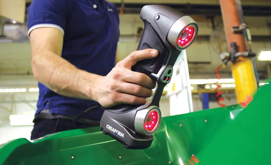

The reference solution for inspection has always been the CMMs, which are fixed to the ground, usually slow, and require bringing the measured piece to the measuring tool. Because of the needed time and generated cost involved in using the CMM on a regular basis, major developments have helped to greatly change FAI.
Portability

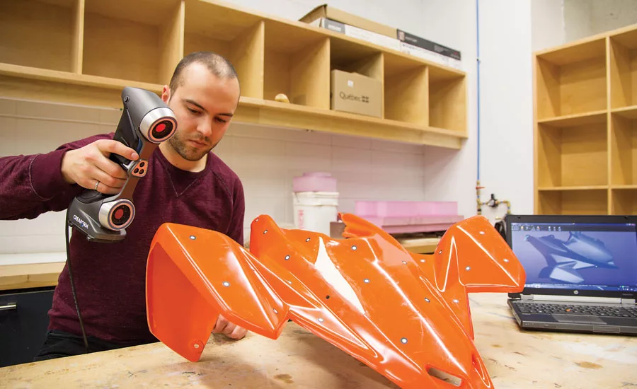

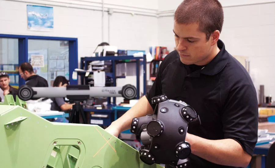

The advent of portable technologies, such as articulated arms, laser trackers, and portable optical CMMs, enable the quality control team to go directly to the production floor, thus eliminating wasted time and reducing the costs related to moving a part from the workshop to the laboratory.
However, the performance of portable CMMs was limited due to the complexity of the production environment. Indeed, shop floor measurements are often synonymous with environmental instability, where it is complex to create a rigid measurement setup. If the measured piece moves, vibrates, or oscillates during the measurement, then 3D inspection and quality testing is not valid.
Reliability
This is how optical portable CMMs, which behave more reliably in a production environment, solved the reliability issues of portable technologies.
Portable CMMs were also limited in the amount of information they could acquire and analyze. They enabled the calculation of a few points, which is acceptable in series production to verify that there is no drift. However, during production of the first pieces, these limited data are often insufficient to support the production team’s analyses. Therefore, a greater information density was required for FAI.
Information Density

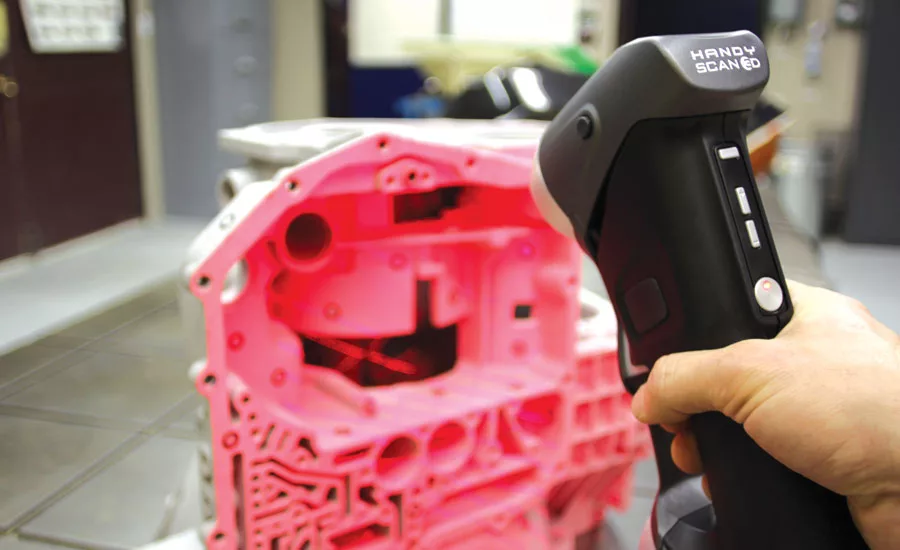

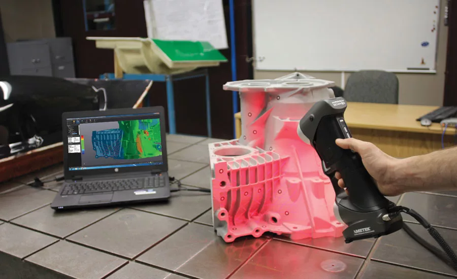

This is when scanners were introduced to digitize a complex shape with a very large number of points and without contact. The arrival of 3D scanners has enabled more detailed analysis of defects on first pieces. For instance, the use of color maps (see the graphic above) reveals where in the process defects appear and which machine setting has created them.
Results
The recent arrival of metrology-grade 3D scanners, which are fast and easy to use, enables FAI to be performed at any time and in any production location. Therefore, the use of 3D scanners avoids the need to physically transport defective parts. Moreover, 3D scanners offer more detailed analyses that are accessible to non-specialists of metrology. They enable shorter ramp-up time and shorter setting and adjustment time, and they limit delays in the detection and correction of first parts’ defects.
In short, the 3D scanner solution optimizes the inspection phase of first pieces by reducing the physical back and forth and bottlenecks at the CMM and, therefore, the time required for necessary adjustments prior to series production. With an optimized inspection, quality service quickly identifies issues, and promptly proposes solutions. Therefore, first pieces are of higher quality, are more compatible, and meet the customer’s requirements, thus generating greater satisfaction, sales, and profitability.
3D scanners can be moved around on the production line (portability), measure in a complex production environment often influenced by temperature variations, vibrations, low-skilled operators, etc. (reliability), and analyze a large number of data (information density). Since the submitted information is more complete, the analysis, problem solving, and decision making are all accelerated.
