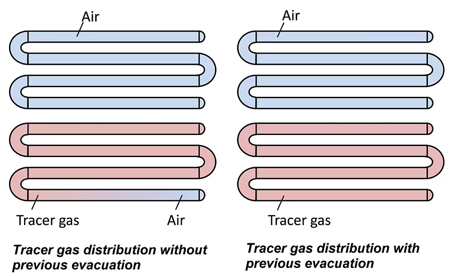

ERROR 6: FILLING WITH A TEST GAS WITHOUT PREVIOUS EVACUATION
For proper leak testing it is absolutely mandatory to evacuate the test part before filling it with tracer gas. This is particularly important for long and narrow geometries. If you do not evacuate before filling, the air in the test part will simply be pushed to the end of the geometry, and no tracer gas will get to that area. That means that potential leaks will only release the trapped air, which will not be detected by your tracer gas leak detector.
Evacuation also is especially important if you fill the part to be tested with low pressures of tracer gas because the trapped air will dilute the tracer gas as it fills the piece. For example: If the part is filled with air at atmospheric pressure and you add one atmosphere of tracer gas, the tracer gas concentration in the part is only 50 percent. If you add two atmospheres of tracer gas, the concentration of tracer gas will be 66 percent.

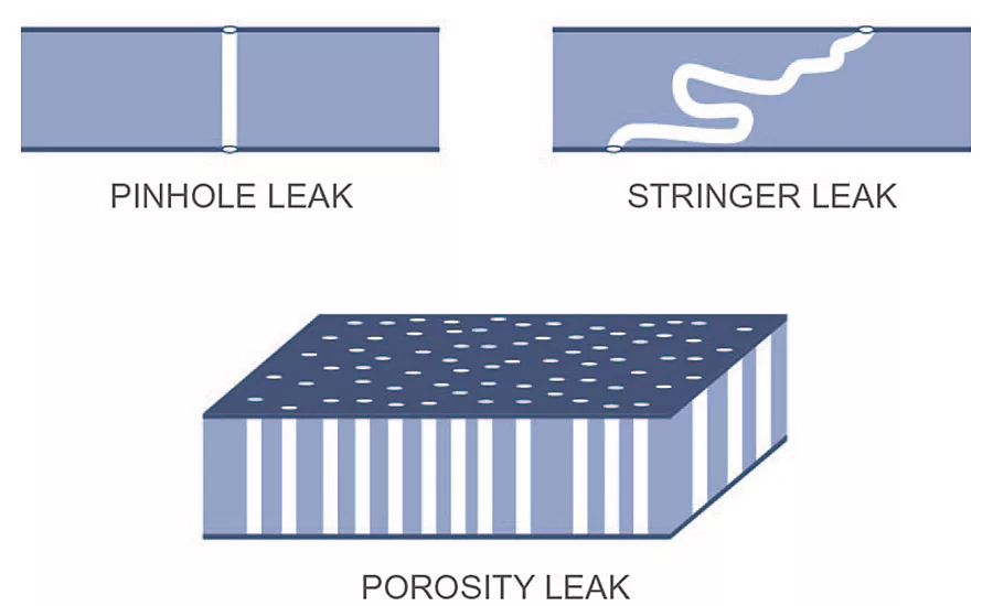

ERROR 8: UNDERESTIMATING STRINGER LEAKS AND GROSS LEAKS
Stringer leaks consisting of capillary-like corridors can seriously affect airbag manufacturers. It is important to consider how long it takes for helium tracer gas to distribute in order to emerge from stringer leaks. If you work with very short times between filling and testing, it may be difficult or even impossible to identify stringer leaks. Another example: Even on cable feed-throughs leak channels could be several centimeters in length. It may take several minutes for the tracer gas to leak through.
The opposite of a stringer leak is a gross leak. In a gross leak the helium escapes from the test piece before the actual test interval. In effect, you evacuate the vacuum test chamber and the helium from the test piece at the same time. Sometimes a simple pressure decay test is integrated into the tracer gas system to identify any gross leaks before filling the test piece with helium.
