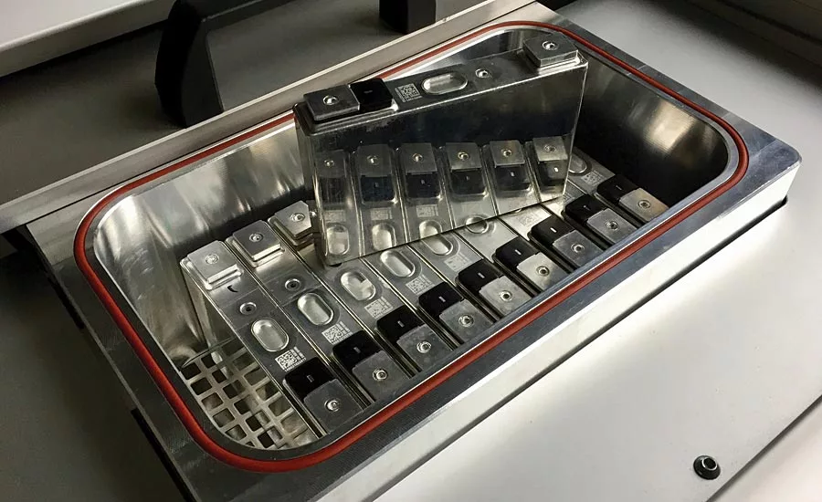

Battery cells are one of three types: prismatic; round or cylindrical like the batteries you buy at the store for electronics; or pouches that are soft sided. Lithium-ion electrolyte and water when mixed create a volatile compound called hydrofluoric acid, which can not only compromise the integrity of the cell, but can create other issues if it escapes from the cell. Because of the volatility of the electrolyte in traction batteries, containing the electrolyte at the cell level and ensuring no leaks is critical throughout the battery’s lifetime. At the end of the traction battery’s 10-year life, the concentration of water in the electrolyte should be as low as possible, but typically no more than 80 parts per million (ppm). This is why air and water tightness are so crucial during the manufacturing process.
While direct contact with water can lead to contamination of the electrolyte, water vapor in the air also can infiltrate the battery cell if it is not tight, and build up to a dangerous point. To keep water vapor out, the maximum allowable leak size is 10-6 mbar·l/s, which is undetectable without specialized leak-detection equipment that utilizes test gases such as helium. The testing is conducted by a sensitive detector using a vacuum chamber.

When validating battery cells, the problem areas are different, depending on the type of cells being tested:
  • Soft pouch cells – These require testing for leaks at the electrodes, as well as at the bag seal
  • Round cells – At the crimped connections between the cylindrical housing and the electrodes
  • Prismatic cells –The welds where the electrode contacts and the cover plate come together
