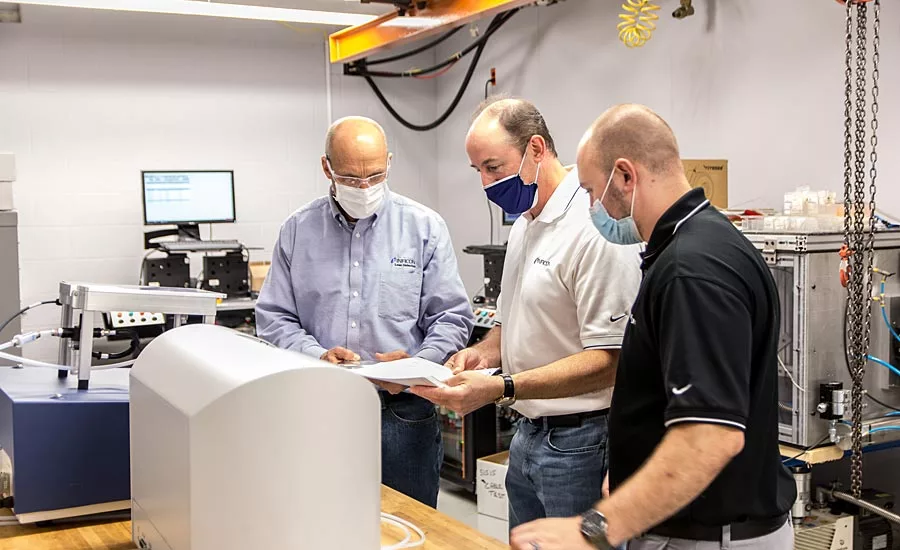

INFICON engineers
INFICON engineers install a new leak-detection system at a KUKA plant in Michigan. Source: INFICON
