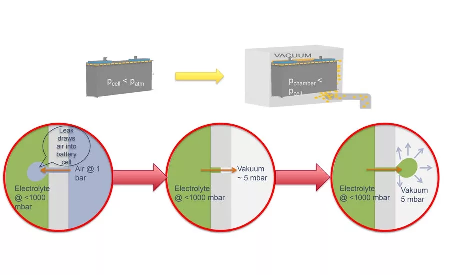

Direct electrolyte leak testing. Source: INFICON
Walls of pouch, cylindrical or prismatic battery cells are often the site of leaks. Using vacuum leak testing equipment and helium, hydrogen or mixed test gas leaks may be readily quantified and quality preserved. Source: INFICON

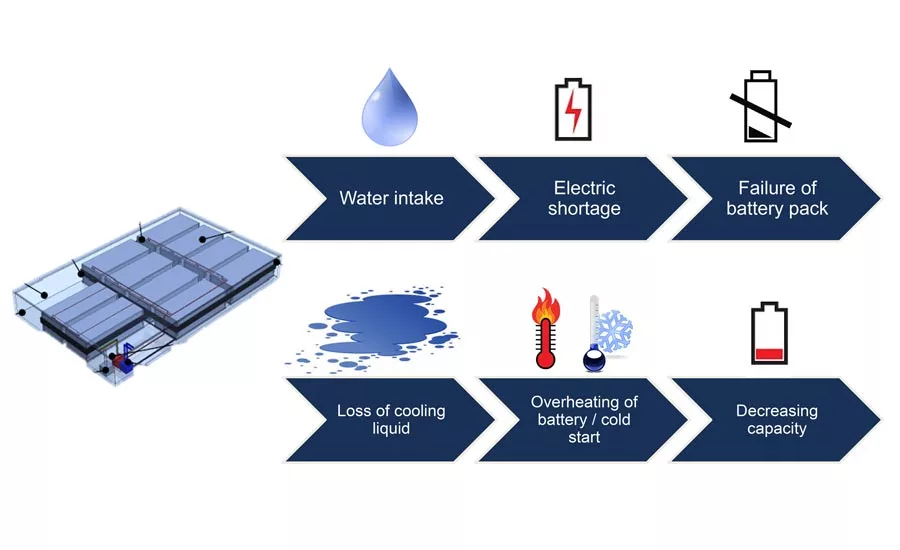

Failure modes battery packs 300dpi. Source: INFICON
Battery cells fail, typically, because of leakage within the cell or loss of battery pack cooling capacity. Source: INFICON

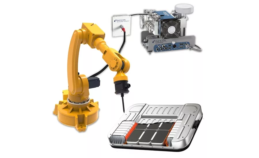

Robot sniffing battery pack with LDS3000-XL. Source: INFICON
Sniffer leak testing with a robotic probe is rapidly growing within the automotive industry, as its accuracy and speed readily adapt to production environments. Source: INFICON

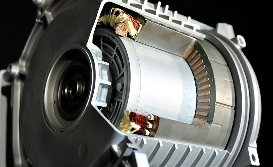

Typical electric drive motor for BEVs. Source: Shutterstock

Tolerable leak-rate levels for battery cells depend on a variety of factors, including pressure conditions within the cell, the cell volume and its required service life. Today, many manufacturers expect a service life of up to 10 years or more. To achieve extended cell life, permissible leak rates for prismatic and cylindrical battery cells fall within a range of 10-5 to 10-6 mbar-l/s.
All battery cells need to be tested for large or so-called gross leaks, as well as for extremely small “capillary” leaks, which are difficult to detect.
Commonly used leak-detection methods such as pressure, helium bombing or visual inspection have proven to be either too slow or unreliable in catching small, but significant battery-cell leaks. (Problems associated with these methodologies along with new, more reliable test methods are discussed in a new e-book published by INFICON and available free of charge at https://bit.ly/3sdRKxq.)
New leak-detection systems based on mass-spectrometer technology now are capable of catching leaks 1,000 times smaller than previously possible. The new mass-spectrometer technology can detect all types of common electrolyte solvent, including DMC, EMC and PP. A flexible test chamber designed to prevent damage to pouch cells also has been developed to enable vacuum testing of pouch cells.

If a manufacturer wants to test the integrity of gaskets or seals on an already assembled battery pack, vacuum testing is not an option. Pressure differences with this type of testing might damage gaskets or destroy already-installed capacitors.
As an alternative, tracer-gas-based sniffer leak detection is recommended for battery packs and assembled housings. A “sniffer” leak detector probe is placed on a robot arm that travels along seals on the component or the test can be done manually.
Once battery packs have been assembled and tested, they still must be installed in an EV. Carmakers then will need to perform additional cooling-circuit tests to check connections to the system’s refrigerant circuit or test the cooling circuit for water-gylcol leakage.

Vehicles with an alternative drive system all are equipped with electric motors. Motor housings must be tested to make sure that water cannot enter from the outside and that their water-filled cooling jackets are leak proof as well.
Cooling circuits are designed for rapid heat transfer. Since pressure-decay testing is sensitive to fluctuations in temperature, vacuum testing with helium is more suitable for motor housings. Leak detection with a less expensive forming gas (5 percent hydrogen/95 percent nitrogen) also can be used.
