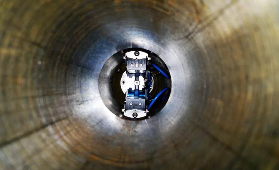

Phased array ultrasonic inspection offers improved precision and coverage for corrosion inspection of process piping. Source: GE Inspection Technologies

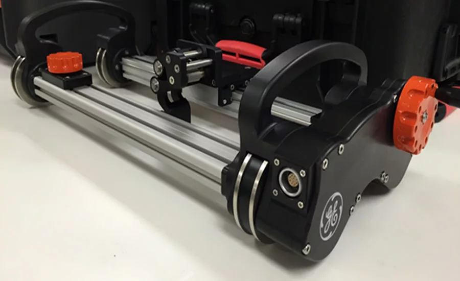

A wide variety of robotic, motorized and manual scanners are available to facilitate wide area ultrasonic scanning. Source: GE Inspection Technologies

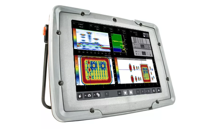

Today’s most advanced ultrasonic flaw detectors operate like smartphones, with customized applications, touch-screen interface and wireless connectivity. Source: GE Inspection Technologies

Ultrasonic phased-array corrosion mapping assists in quickly scanning, detecting, profiling and sizing of pitting and erosion in pipes and tanks. Encoded scanning data allows a high degree of repeatability and ensures 100% coverage to compare asset conditions and track corrosion rates over time.
Conducting accurate, precise corrosion inspection takes more than just an ultrasonic flaw detector or A-scan thickness gage—selecting a scanner, probe and accessory configuration for your application is a critical part of inspection planning. The right setup can make or break your inspection.

Robotic or motorized corrosion scanners are particularly useful for inspection in confined spaces or overhead pipe runs, where it is unsafe or impractical to introduce a live inspector. During a maintenance turnaround where time is critical, it is often desirable to avoid the time delays and costs associated with ventilation, rigging, scaffolding or hole watch. The use of a robotic scanner or crawler can pay for itself in a single turnaround.

Manual scanners operate in much the same way as a motorized scanner, but with the requirement of a live inspector to physically move and operate them. Because they have fewer moving parts they can be very reliable. However to ensure accurate encoding of the scanned surface area, they require strong magnets and precision mechanics. It is advisable to train operators on manual scanning carefully to ensure consistent procedures.
High quality UT instruments are compatible with a variety of commercially available aftermarket scanners and robotic systems to meet virtually any corrosion mapping need.

For productive and precise corrosion inspection, software can be just as important as probe and scanning hardware. Today a new generation of “app-based” UT flaw detectors operate much like a smartphone, allowing users to customize their device interface and build error-reducing guided inspection procedures. These “apps” can automatically identify compatible probes, improve calibration consistency and lock-out unnecessary device parameters, ensuring more reliable and repeatable inspection data. In addition, remote collaboration and live streaming via wireless internet streamlines reporting and allows experts to offer second opinions on tough inspection calls.
