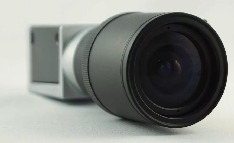

Small camera with big lens. Source: EVT

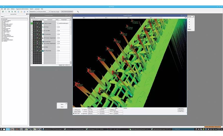

Connector 3D pin inspection with EyeVision software. Source: EVT

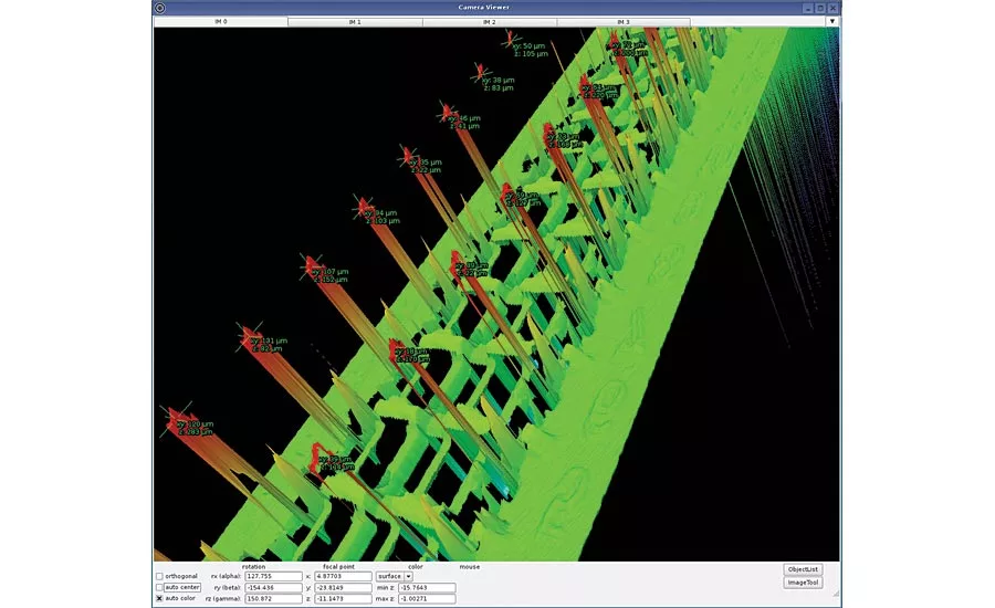

3D point cloud detail of pin inspection. Source: EVT

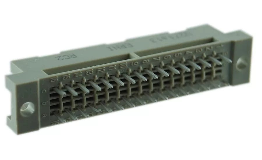

Connector 3D point cloud. Source: EVT

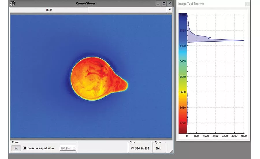

Thermal imaging EyeVision software milk jug. Source: EVT

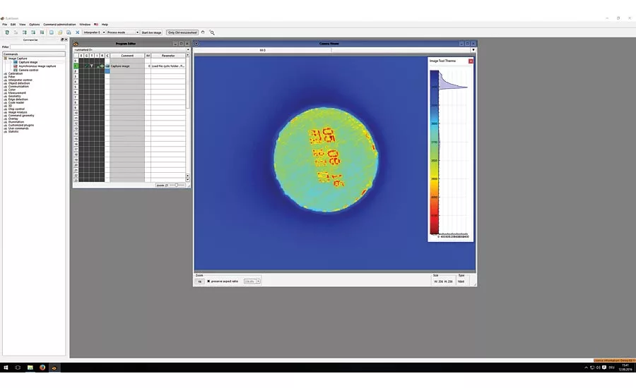

EyeVision software screenshot of thermal imaging. Source: EVT

But the most common technique is the laser line scan with on-board preprocessing. The 3D laser profile measurement is based on the principle of triangulation. For a typical setup, the laser is positioned directly above the object and the camera is positioned with an angle of 30° to the laser. A laser triangulation sensor has significant advantages so it is good for a detailed measurement. An example would be the inspection of pins on a connector. There one can measure the wobble circle and pin depth. When capturing a 3D image from a connector, one can see very clearly if the pin is bent or if the pin is set too deep into the connector or if it is sticking out too far. This is because the inspection program not only measures the pin-peaks in x- and y-direction but also in z-direction.
Relatively new are terms such as nondestructive testing. Due to the new development of thermal imaging in machine vision, it is now possible to detect the quality of a product, according to the temperature, without changing the product, or without damaging the product. Thermal imaging cameras capture data such as if a seal edge is completely gasketed or if fiber-reinforced composites are broken inside.
This means that, for example, in the food & beverage industry the inspection of packaging sealing, fill level or the temperature of perishables is a significant part of quality control. Up to now some quality characteristics could only be checked by taking samples. Nowadays, a continuous inspection of all products is possible, thanks to thermal imaging. To inspect a nontransparent plastic bottle and its contents, often thermal imaging cameras are used. And what’s more, the label print, the flawlessness of the exterior and fill level of the bottle can be inspected at the same instant. This then results in a higher process efficiency and productive capacity with checked quality. The thermal imaging camera recognizes the radiation of the temperature of the liquid inside the bottle. The IR-image is then evaluated via machine vision software.
The definite benefit: instead of having to take samples and insert them into measuring plants to control the quality of the product, the image processing system is integrated into the production process and measures each component, without having to reduce the production flow and speed.

Another trend is the miniaturization of the image processing hardware. Is it really a demand of the production plants that industrial and smart cameras have to shrink to the size of a thumbnail?
Of course there is a market for compact and small systems, even when they are then built into a big production plant, where there would be space for an embedded system. But it is another question, if this is really necessary for the machine vision solution.
Surely there are applications where there is not much space for the camera. An example would be a robot arm for grabbing small objects. This means that the robot arm itself should be quite small as well. In this regard the miniaturization for the semiconductor industry has moved things forward and so now almost all demands in size can be fulfilled.
In a nutshell, there are applications where the cameras have to be smaller and smaller, but for the majority of cases, this is not necessary. If you just have a look at the physics, the increasing miniaturization can lead to absurd constructions. For example, the lenses are sometimes much bigger than the cameras. And therefore the camera does not get mounted on the production plant, but the lens, and the camera is then mounted on the lens.
