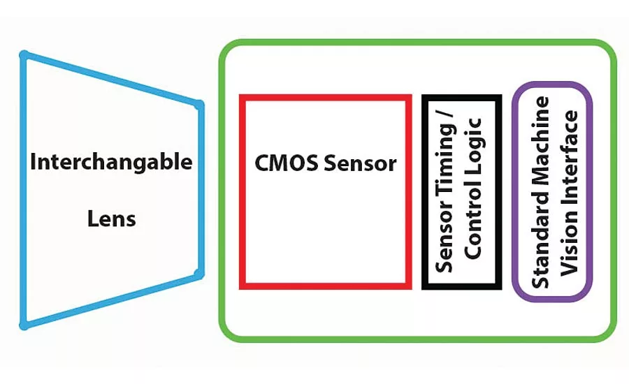

Machine vision camera head design. Source: Fastec

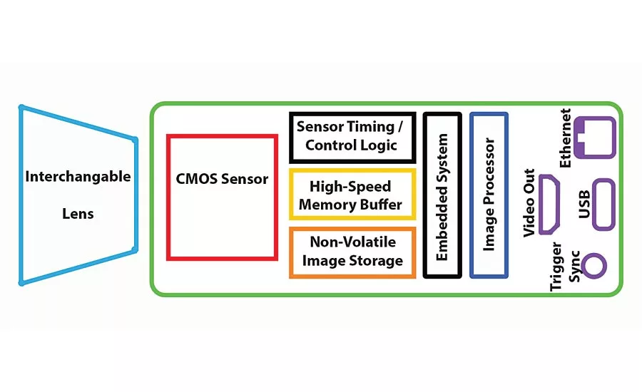

Integrated high-speed CMOS camera: complex design. Source: Fastec

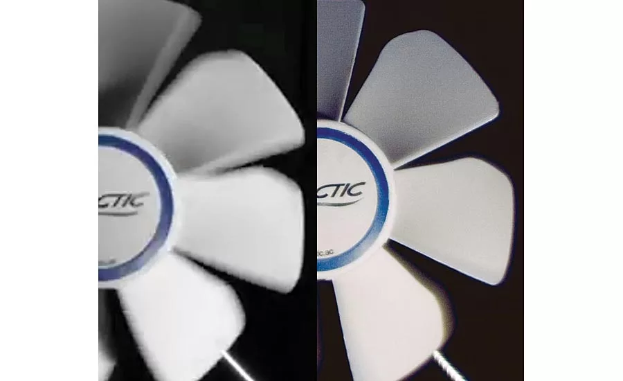

Both fan images use the same lighting with the fan rotating at the same speed. The image on the left is from a digital camera using “slo-mo” mode. The vertical fan blades exhibit motion distortion. Motion blur also is evident. The image on the right was taken at 1100fps with a 3ms shutter. No motion blur or distortion is present. Source: Fastec

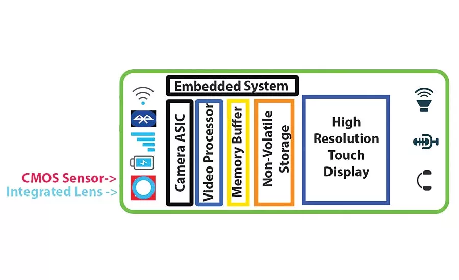

Cell phone CMOS camera:  Highly integrated design. Source: Fastec

Machine vision cameras are produced in high numbers, which drive both sensor and lens development. The cameras are simple, composed only of optics, sensor, and interface. Image data is delivered from the camera over a standard interface to a frame grabber. Image content is analyzed for decision-making rather than for human viewing. Global shutters and short exposures minimize motion blur and distortion to facilitate analysis.
High-speed integrated cameras, while used in a wide range of applications, are not produced in numbers high enough to drive sensor or lens development. Most incorporate sensors developed for machine vision, or proprietary, small-production (expensive) sensors designed for a few high-end camera companies. The cameras may use industrial, SLR, or cinema lenses, and many require a PC or tethered processor for control functions, although most have complex embedded systems and can be operated autonomously.
High-speed integrated cameras commonly produce raw image data that may be transferred as sequences of discrete images, as well as video formats, which is important because frame-by-frame analysis is crucial for many applications. While recording, raw images are written to memory buffers within the camera, to be transferred to nonvolatile storage post-capture. Some newer cameras stream raw high-speed image data directly to nonvolatile storage. Advanced triggering functions are critical for capturing fleeting high-speed events and for precisely triggering groups of frame-synchronized cameras for 3D modeling and analysis.

Consumer digital cameras and cell phone cameras enjoy economies of scale, benefitting from advanced technologies such as back-illuminated, stacked sensors that manage impressive light sensitivity despite their diminutive size. The “slo-mo” output of these cameras is generally highly-processed, interpolated compressed video for viewing on the device and sharing on the internet. Although capable of compelling video, motion distortion caused by rolling shutters make these cameras inappropriate for troubleshooting and motion analysis (see the fans image). Automatic control of focus and exposure, as well as built-in optics, limits their flexibility.
