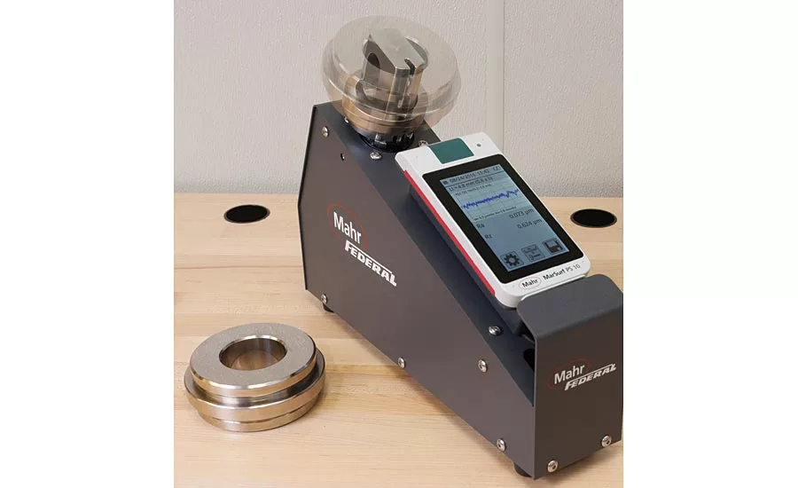

Newer Portable Surface Gages: The latest portable surface gages interface with the user just like a smart phone. They require very little training and can be used by the operator in minutes. The units are smart enough to automate filter setting and cut off selection, providing the best results for the user. Also, users can customize the screen and the measurements so they only see the results they need without having to sift through a lot of unneeded information. For fast access to commonly used features the display can be customized to show “favorite” functions such as sending data or accessing specific trace details.
Again like a smart phone, the unit’s display adjusts to allow measurement in any position—horizontally, vertically or upside down—to provide the best viewing angle for the operator.

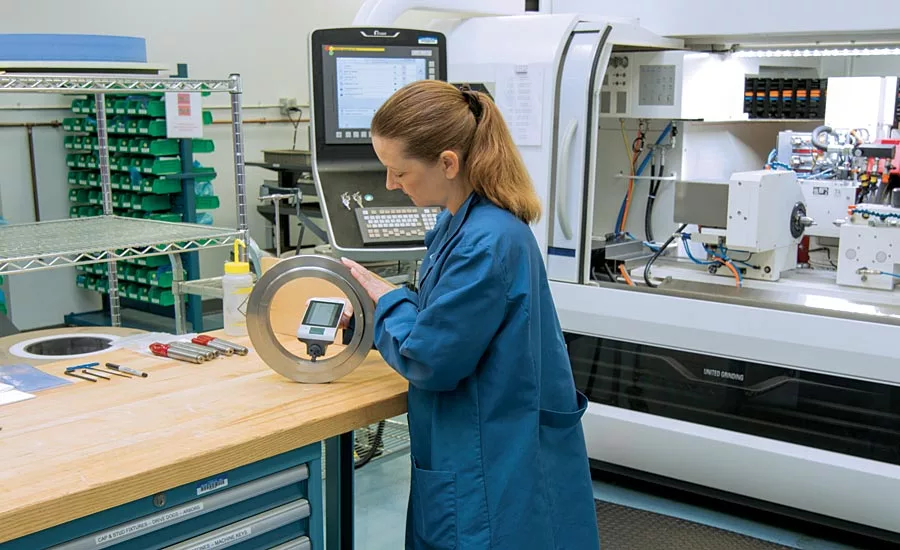

So, now that the machinist has also become a surface finish inspector he might as well have the tools to become a data collection and analysis expert as well. New portable surface finish products make the collection or transfer of measurement results transparent to the user. With each measurement cycle, settings allow for data results to be saved automatically on the device both in data and PDF formats. At the same time the results can be sent automatically through an output connector (or wireless data transmitter) to a computer for Excel, or third party data collection and SPC analysis. All this is done with just the single start button and no added steps by the user.

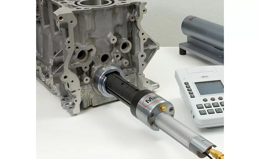

Cylinder Bores: Take measuring cylinder bores as an example. Cylinder bores were probably the first application to have dedicated gaging designed for measuring surface finish. Characteristics include bores of various sizes, which can be relatively deep, some up to 8 inches. The prints may call out specific depths and locations for checks, and with up to 12 cylinders in some blocks and four in a vast majority of high volume applications, there are a lot of bores to measure. Therefore the gages need to be highly portable and easy for the operator to align and set to depth. The design also has to protect the sensitive probe so it does not get damaged when bringing the gage to the part.
The dedicated portable surface finish bore gage is much like an expandable tri-bore gage. The tri-bore has a certain amount of size adjustment, but can be set to a specific size. This allows it to “lock” in place and helps provide very repeatable readings with no operator influence. The indicating device is also protected by a transfer mechanism so there are no locating forces applied to it when the gage is placed onto the part.
The surface finish cylinder bore gage borrows the same principles. To give it adjustability to lock into various sizes, interchangeable plates are used to achieve the right measuring range for the diameter. Setting the gage with the right set of blocks allows easy entry into the cylinder bore, and once in place, a manually controlled air cylinder expands the sizing blocks so they lock the gage into position. The clamping force is such that a user can virtually pick up the block with the gage (although this should only be done by serious weightlifters).
But the gage’s cylinder has another even more critical function. When compressed with no air applied, it holds the sensitive surface finish probe in a retracted position. This means that during insertion the probe is protected inside the body of the gage. Once the operator is satisfied with the gage location, he applies the air, locks the gage into position, and the probe extends so he can make the surface test. When done, the air is released, the probe retracts, and the gage becomes free, allowing easy removal by the user.

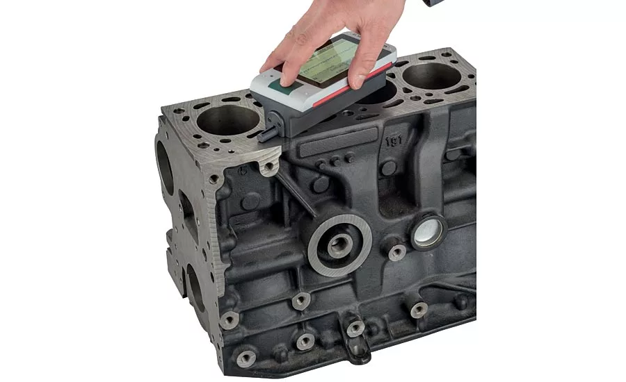

Small Bores: Some bores in the block are not as large as cylinder bores, but also require shop floor surface measurement. Here another tack can be taken. Again borrowing from the world of precision dimensional hand gaging, a takeoff on the fixed mechanical plug can be incorporated. With this type of gage, the mechanical body of the plug is made to measure a specific bore size. Thus it is fast, self-centering, and there is no operator influence.
The same concept can be used for a portable surface finish gage. In this case, a plug body, made close to the bore size being measured, incorporates a surface finish probe. But unlike a fixed mechanical plug, which always has its contacts touching the bore, the surface finish version keeps the probe retracted until the plug is in its final measuring position. Then a mechanical transfer mechanism releases it.
Other examples of surface gages for automotive parts include crankshafts and camshafts, along with the interrupted bores that they go into. A critical roughness and waviness check includes the deck face of heads and blocks to ensure a good leak-free seal when assembled.

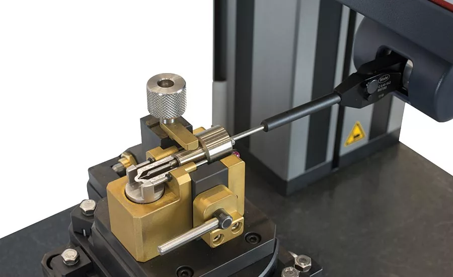

An example of this is the measurement of various fuel injection nozzle bodies. A fully automatic CNC measuring station enables the measurement of contour and roughness of the entire cone of the nozzle seat, from the blind hole to the guide diameter. Using a very small probe tip (0.45 mm total height), a blind hole with diameter of up to approximately 0.6 mm can be entered. The customized software routine allows the fully automatic measurement of the entire inner contour of the workpiece.
Probe arms and workpiece holder dimensions are stored in a coordinate system, so that no further setting of the measuring station is required during operation. Using “workpiece recognition” and an automatic probe arm change unit, the degree of automation can be designed to any extent up to completely operator-independent execution. With the “palette measurement” option, the measurement of several identical workpieces can be performed without operator involvement, allowing the system to run lights out overnight to complete the entire pallet.
