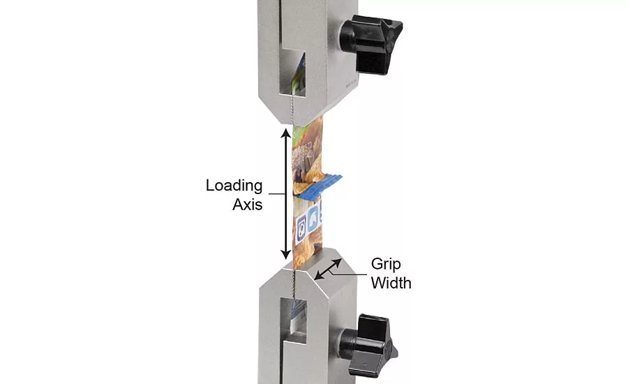

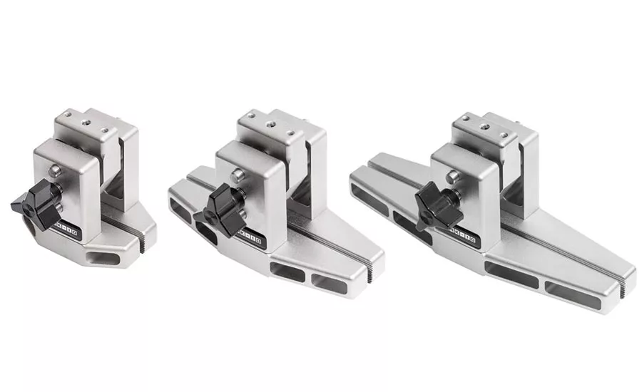

Select the smallest applicable grip width
Grip width refers to the length of the non-opening dimension of the grip, which runs perpendicular to the loading axis. Grip width describes the widest sample size that a grip can accommodate.
Often, there will be a basic grip design that is available in several different grip widths. The most common example is grips for peel testing. Since peel strength results are calculated in terms of force per unit width (such as lbF/in or N/cm), films, seals and adhesives need to be tested in a variety of specified widths. Therefore, it is common for a particular peel testing grip design to be available in several widths.
In cases like this, it is best to choose the smallest grip width that will still accommodate the sample. If several sample widths require testing, it is advised to use several grips, instead of one larger grip to accommodate all sample widths.
While the widthwise edges of the grip should always extend beyond the sample edge, having a grip width that is only slightly larger than its sample improves the operator’s ability to visually inspect sample alignment. If the edges of a sample run immediately adjacent of those of the grip, it will make sample misalignment more obvious.

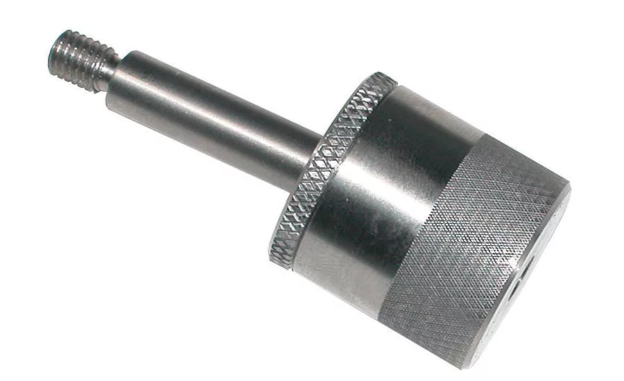

Adding a swivel joint for tensile measurements
The simple swivel joint accessory has one of the largest performance to price ratios in all of force testing—and is also one of the most underutilized.
If a sample exhibits asymmetric elongation when subjected to a tensile force, it will apply an eccentric and/or torsional load to the force sensor when tested. Eccentric and torsional loads can induce extreme measurement errors—and even cause damage—to many force sensors.
Inserting a swivel joint into the load chain does not directly address the cause of the off-axis loading but can mitigate some of its negative impacts. This is achieved by better centering the force vector and preventing a force sensor from being rigidly coupled to a bending or twisting load.
An added benefit of a swivel joint is it can make misalignment issues immediately obvious. With a swivel joint, a sample is able to swing freely in space and will hang off to one side when asymmetrically loaded. This will allow the operator to more frequently identify and correct such issues. Without a swivel joint in the load chain, the force sensor will be rigidly coupled to the sample, potentially hiding a misalignment issue.

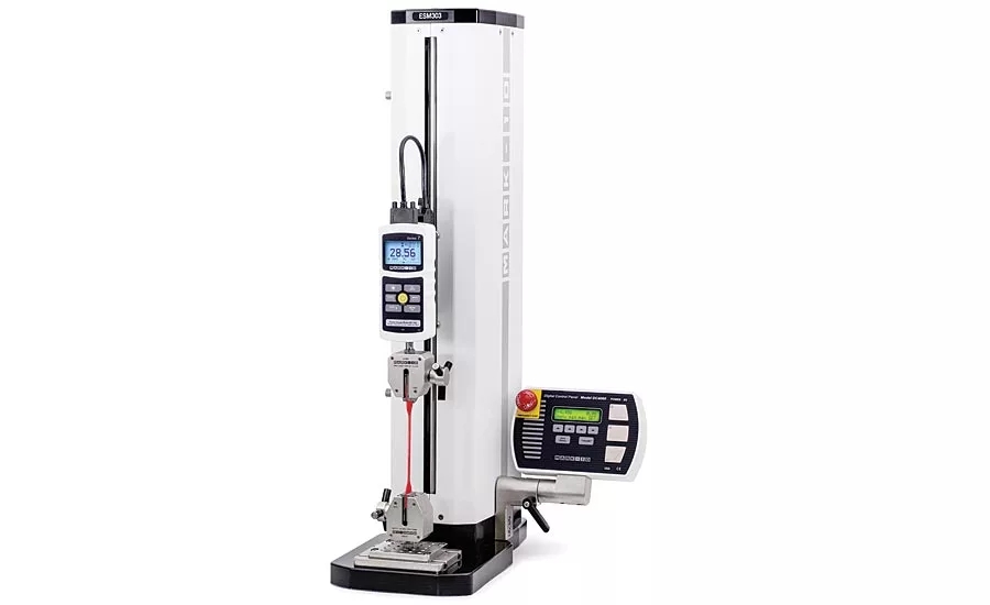

Caution: Automatic preloading from wedge-action grips
Wedge-action grips are valued for their unique ability to tighten automatically as the sample thins during tensile testing, thereby preventing slippage. This self-tightening feature is initiated by an internal spring mechanism that constantly applies a small pinch load to the sample. This mechanism enhances ease-of-use while creating a more repeatable “first bite” from the jaws.
But, a complication of this wedge action is that the jaws simultaneously move along the loading axis as they pinch inward. So, this initial pinch inward is accompanied by a compressive load applied to each sample.
Often, an operator will make a habit of zeroing the force display immediately after the sample is secured within the grips. This can be problematic with wedge grips because of the compressive loads they naturally generate. Zeroing the force channel with this preload applied will cause subsequent tensile force measurements to contain an artificial offset, inflating measurement results.

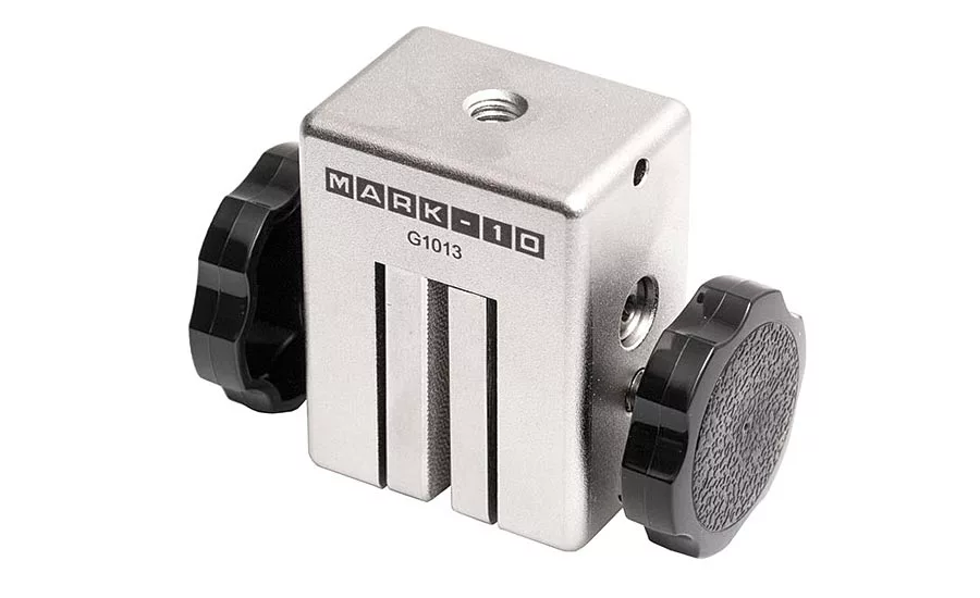

An effective solution, which is particularly effective when working with more rigid samples, is to instead choose parallel jaw grips. As the name suggests, parallel jaw grips have jaws that run parallel to the loading axis, so their inward pinch acts entirely perpendicular to the loading axis. Thus, unlike wedge grips, parallel jaw grips can apply a pinch load without necessarily creating a preload.
Caution: Sample squirt from parallel jaw grips
Although parallel jaw grips do not generate a compressive preload through their direct action, they do still sometimes exhibit a different preloading issue: “sample squirt.” As their strong inward pinch load is applied to more elastic samples, the sample will often be squeezed outward from the jaws. The effectively longer length of sample that is now situated within the original grip spacing will result in a compressive preload and/or added slack in the load chain.
The Resolution
To solve the issues of preloading from wedge grips and sample squirt from parallel jaw grips, the best option is typically to utilize a test system with a preload feature. This feature can instruct the crosshead of the test machine to travel to a configurable load before establishing the test datum. In the case of wedge grips, this will relax the compressive preload before establishing a force/displacement zero. In the case of parallel jaw grips, this will remove the added sample slack before establishing a force/displacement zero.
In both cases, utilizing a preload will create a known and reproducible set of initial test conditions that will greatly improve measurement accuracy and repeatability for both the force and displacement dimensions. In applications where accuracy and repeatability are critical, the preload feature can be indispensable.
