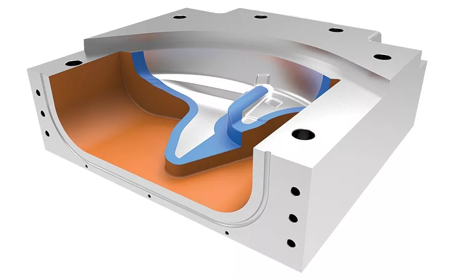

One half of the finished layup tooling.

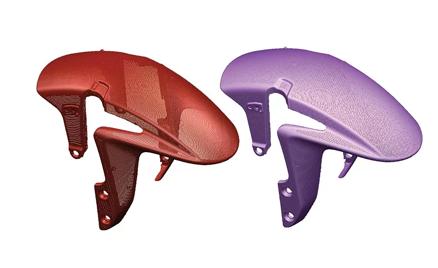

Point cloud converted to a mesh of nearly one million triangles.

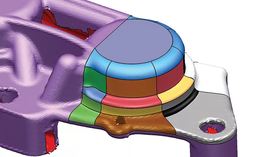

 Partial shrink-wrap of a simple part.

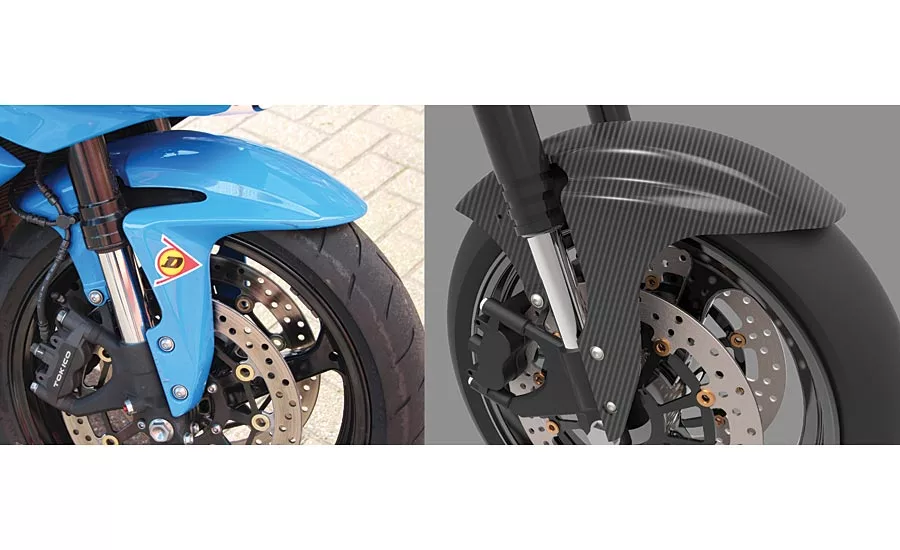

Original mudguard for a Honda CBR 600, and proposed carbon fiber after-market replacement.

After-market automotive parts give customers a wider choice of replacement parts. They also offer the customer significant savings, typically costing much less than the ‘official’ equivalent. Typical examples include body panels and trim parts, for which tooling must usually also be made. Although this represents a significant investment for manufacturers, the rewards can be substantial, with the market being estimated at over $3 billion a year in the U.S. alone.  This value is likely to increase further as manufacturers look to the possibility of creating specialist engineered-to-fit parts in more exotic materials such as carbon fiber.

Reverse engineering begins with the acquisition of the part geometry itself, usually using some form of scanner. The choice of scanning technology depends heavily on the type of part being scanned. Parts with lots of surface texture and color are best scanned using photogrammetry techniques, while those with complex 3D forms are often better suited to scanning with laser. Most modern scanners can capture in excess of half a million points per second, producing a ‘cloud’ of 3D points, which is then converted into a mesh of triangles.

Shrink-wrapping cloaks a shape in a patchwork of close-fitting surface patches. The advantage of this method is that the process is largely automatic, often requiring little or no user intervention, apart from specifying the patch density.  If the end use of the model is to acquire a CAD record of a part from which no CAD exists, or to recreate the part using 3D printing, or similar process, the speed and simplicity of shrink-wrapping make it an obvious candidate.
The disadvantage is that it is virtually impossible to edit the model in any meaningful way. For example, offsetting a planar region to provide machining allowance for cast parts may require several dozen surfaces to be modified—not just the face itself. Offsetting the initial face is quite a simple task. Ensuring all neighboring faces are updated whilst also maintaining tangency, is considerably more challenging and likely to require a lot more time and effort. If the surrounding regions are especially complex, this kind of change becomes very difficult indeed. Add complex free-flowing fillets, and it becomes almost impossible.
Another disadvantage of shrink-wrapping is that it generally requires a completely closed and watertight mesh, as otherwise the surfaces may become badly distorted in undefined regions, as they attempt to match up with surrounding faces. If the part surface is hard to scan, for example if it is very shiny, then the amount of time taken to fully repair the mesh may outweigh the speed gains.
