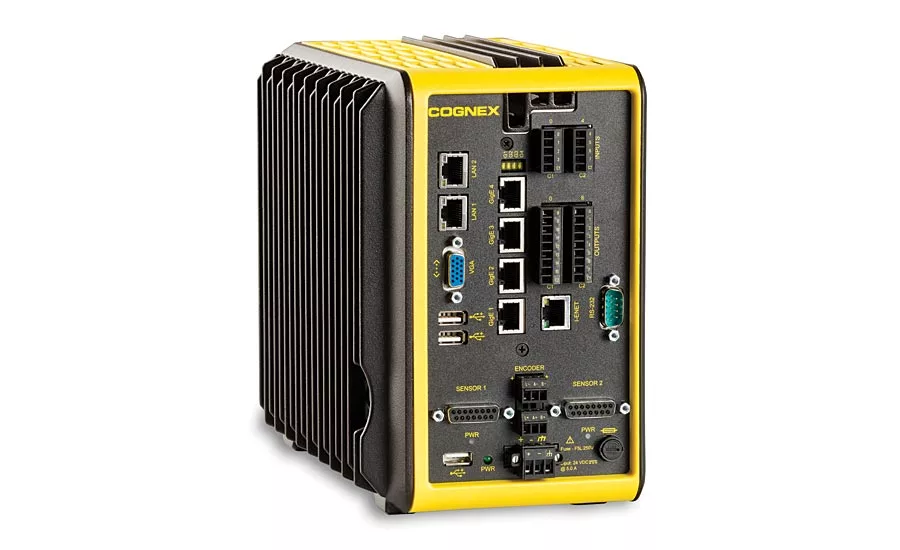

Different Machine Vision Network Interface Options
The VC5 Vision Controller directly connects to GigE Vision cameras. Source: Cognex
