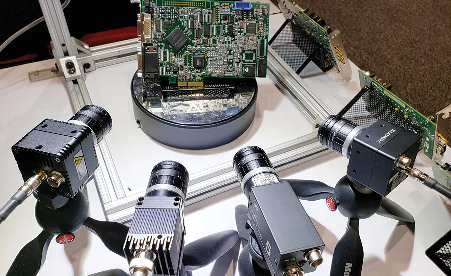

CXP frame grabbers
This is a multi-camera system using CXP frame grabbers.
