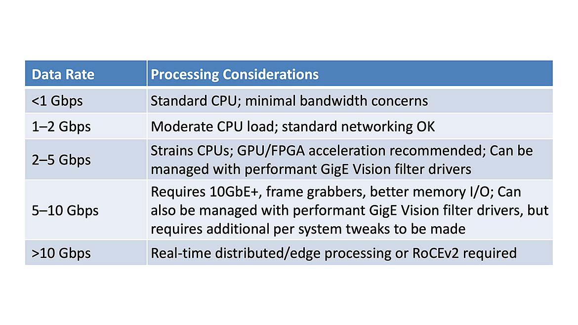

The Shift from Bandwidth to Processing
For years, the focus in machine vision design was on increasing bandwidth to accommodate higher data volumes. GigE Vision, for example, scaled from 1 Gbps to 10 Gbps and beyond. However, as systems push toward 4K and 8K video, real-time streaming, and continuous operation, the bottleneck has shifted. Host systems—particularly CPUs—struggle to process incoming data efficiently, leading to latency, dropped frames, and reduced system responsiveness.
At data rates below 1 Gbps, standard CPUs can manage the workload comfortably. Between 2 and 5 Gbps, CPU strain becomes noticeable, prompting the use of GPUs or FPGAs for acceleration. In the 5 to 10 Gbps range, traditional PC architectures begin to falter, requiring frame grabbers, optimized memory I/O, and system-level tuning. Beyond 10 Gbps, host CPUs alone are insufficient, and designers must adopt advanced strategies such as edge processing and remote direct memory access (RDMA).

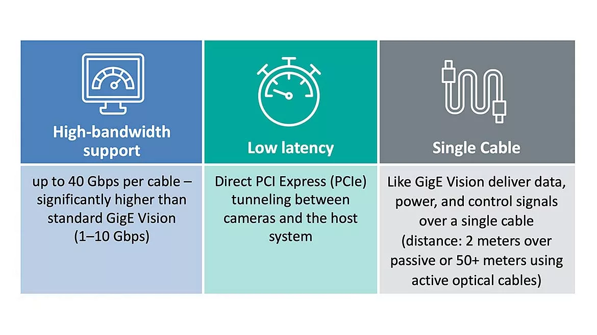

Thunderbolt: A High-Bandwidth Alternative
Thunderbolt technology has emerged as a compelling solution for machine vision applications operating in the 10 Gbps range and beyond. Thunderbolt 3 and 4 support up to 40 Gbps per cable, while Thunderbolt 5 is approaching 80 Gbps. This represents a significant leap over standard GigE Vision interfaces.
Thunderbolt enables direct PCIe tunneling, allowing data from the camera to be transferred directly to the host system’s memory with minimal overhead. This dramatically reduces latency, which is critical for real-time decision-making. Like GigE Vision, Thunderbolt can deliver data, power, and control signals over a single cable, simplifying system design and reducing clutter.
Thunderbolt Performance Benchmarks
Real-world implementations of Thunderbolt in machine vision systems have demonstrated:
  • Thunderbolt 3: Up to 40 Gbps total bandwidth; PCIe data transfer typically ranges from 16–32 Gbps depending on system configuration.
  • Thunderbolt 4: Maintains 40 Gbps bandwidth with guaranteed 32 Gbps PCIe throughput and support for dual 4K displays at 60 Hz.
  • Thunderbolt 5: Doubles PCIe throughput to 64 Gbps and supports up to 120 Gbps for video with Bandwidth Boost, enabling triple 4K displays at 144 Hz or dual 8K displays.
In industrial setups using Jetson-based embedded systems, Thunderbolt uplinks have enabled seamless integration of high-end GPUs and measurement cards, achieving consistent throughput near the 40 Gbps ceiling with low latency and minimal CPU overhead.
Evixmatic 20
Image 2: Thunderbolt single-cable connectivity enables low-latency, high-performance machine vision systems.

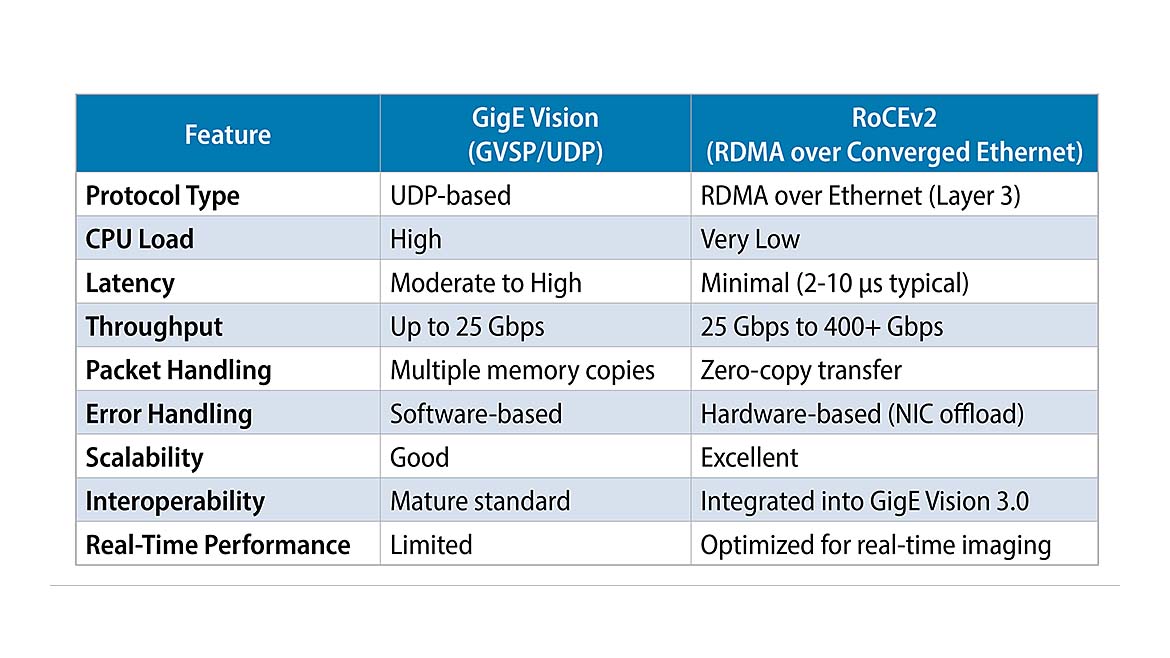

RoCEv2: Enabling Zero-Copy Data Transfer
Remote Direct Memory Access over Converged Ethernet (RoCEv2) is a protocol derived from the InfiniBand specification that enables direct memory access over Ethernet. RoCEv2 allows imaging data to be transferred directly from the camera or sensor to the host processor’s memory without involving the CPU, operating system, or cache.
This zero-copy transfer significantly lowers latency and frees CPU resources for value-added tasks such as image analysis and AI inference. RoCEv2 operates over Layer 3 Ethernet, making it routable across IP networks and suitable for distributed systems. It supports high-throughput links of 25 Gbps and beyond, enabling multiple high-resolution, high-frame-rate streams with minimal CPU usage.
RoCEv2’s integration into GigE Vision 3.0 marks a significant evolution in machine vision standards, offering a future-proof path for high-performance, scalable imaging systems.
Evixmatic 20
Table 1: RoCEv2 vs GigE Vision: Key Differences

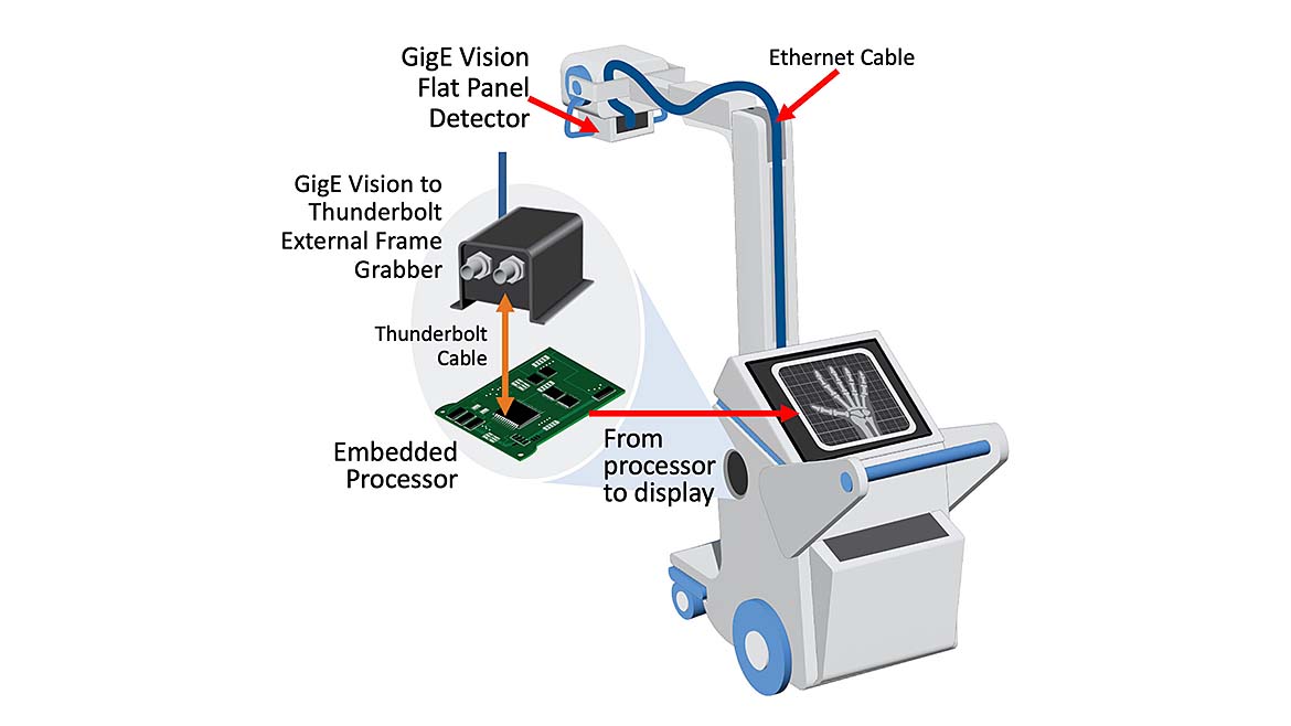

Medical Imaging
One of the fastest-growing markets for machine vision is point-of-care and mobile diagnostics. Bedside imaging systems in emergency rooms and ICUs, portable veterinary platforms, and mobile health units all benefit from high-speed data transfer and compact form factors. Thunderbolt and RoCEv2 enable real-time display and analysis while reducing hardware costs and improving mobility.
Evixmatic 20
Image 3: GigE Vision flat panel detector connected via Ethernet to a Thunderbolt frame grabber enables high-speed data transfer to an embedded processor for real-time display and analysis.
