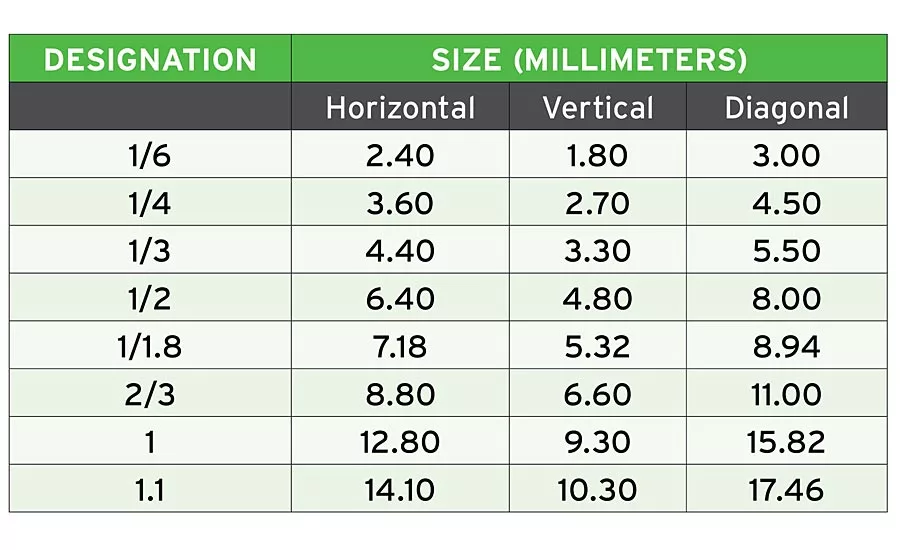

Lens Format
Lenses are design-limited to work with a maximum sensor size, and lens format designations are related to the size of the maximum image circle produced by the lens. The format “titles” are somewhat outdated, and do not match the diagonal size of modern sensors. Use the abbreviated chart included with this article or find a more extensive chart online to match the lens format to the sensor format. In our example, the sensor diagonal can be calculated using the pixel size (3.45um) and sensor resolution (2448x2048) as 11.01mm or a “2/3 inch” format.
