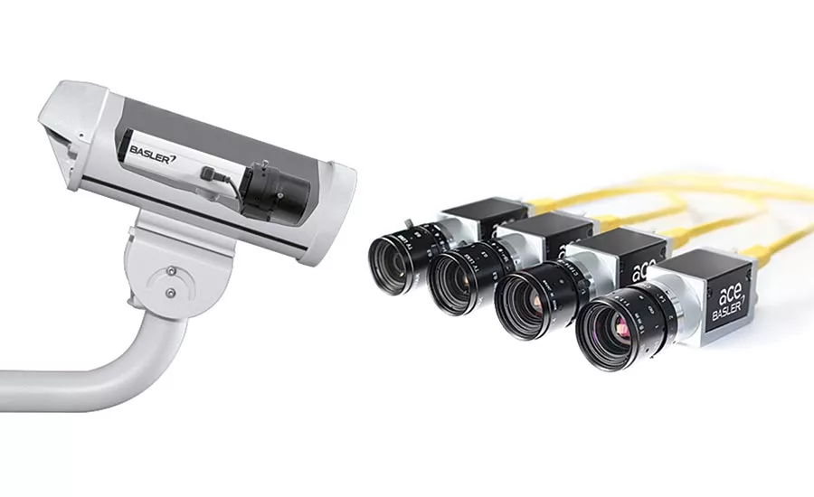

IP camera (left) and industrial camera (right).

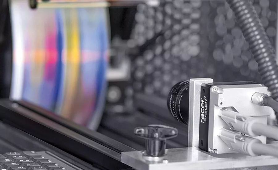

Line-scan camera can check the quality of goods at speeds up to 60mph.  Source: Basler

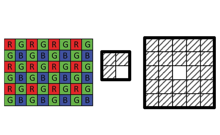

The Bayer matrix (left), 2×2 (middle) and 5×5 (right) debayering algorithms. Source: Basler

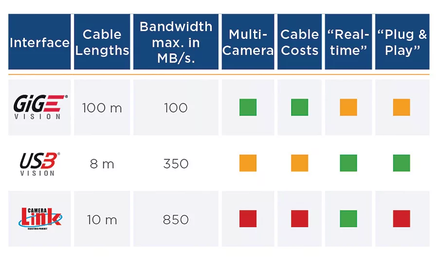

Interface comparison by cable length, bandwidth and other factors. Source: Basler

Machine vision vs. Surveillance
For most applications in factory automation or the medical field you will need a machine vision camera. A machine vision camera captures image data and sends it uncompressed to the PC. This is the reason why pictures look less “pretty” than the ones from cell phones. In consumer cameras the image data gets compressed and smoothed out which looks good, but doesn’t provide the quality needed for flaw detection and code reading.
Network cameras or IP (Internet Protocol) cameras record video and compress it. Their advantage is their robustness and resistance to vibration and temperature spikes. They are also tolerant to poor lighting conditions and direct sunlight. IP cameras are mainly used in surveillance and in Intelligent Traffic Systems (ITS) applications, for example, for road tolling and red light detection.
Area scan vs. Line scan
If you have a high-speed application with a conveyor belt, you will need a line scan camera. These cameras use a single line of pixels (sometimes two or three lines) to capture the image data. They can check the printing quality of newspapers at a speed up to 60 mph, quickly sort letters and packages in logistics, inspect food for damages. They also control the quality of plastic films, steel, textiles, wafers and electronics.

Monochrome vs. Color
Monochrome cameras are mostly a better choice if the application does not require a color analysis. Because they don’t need a color filter, they are more sensitive than color cameras and deliver more detailed images.
Most of the color machine vision cameras use the Bayer matrix to capture color data. Each pixel has a color filter, half of them green and a quarter red and blue each. The debayering algorithm uses the information from adjoining pixels to determine the color of each pixel. So a 2×2 debayering reads the information from three adjoining pixels and 5×5 debayering reads the information from 24 adjoining pixels. So if you need a color camera, the bigger the debayering number, the better.

Interface
If your camera is far from the PC or if you need multiple cameras in one system, you’ll need GigE. It allows cable lengths up to 100 m and makes multi-camera integration easy. However, USB 3.0 gives you more than three times the bandwidth (350 MB/s versus 100 MB/s), is plug-and-play and has power and data via one cable. It can work with cable lengths only up to 8 m. If you need the highest possible bandwidth—up to 850 MB/s—then Camera Link is the best choice. Camera Link requires a frame grabber and so the system costs are higher.
