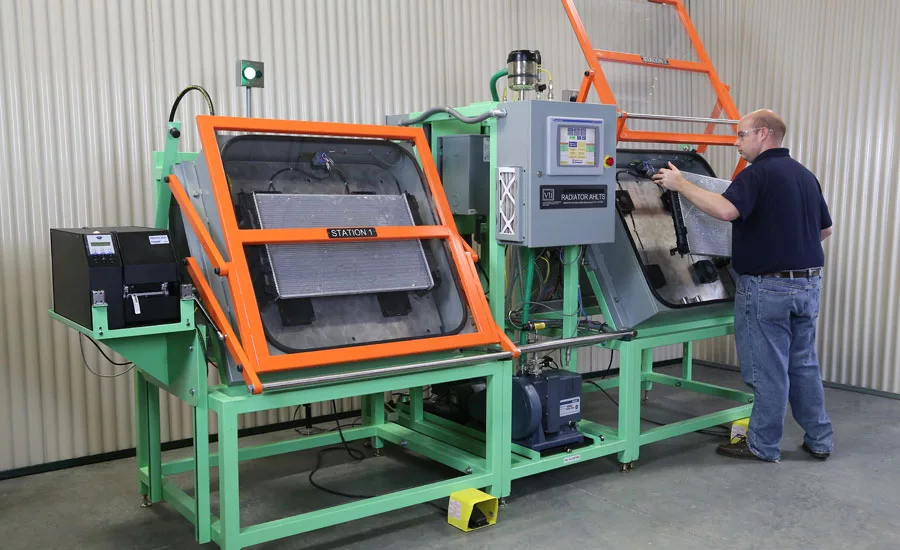

A technician loads a radiator into an atmospheric helium leak testing machine. Source: Inficon

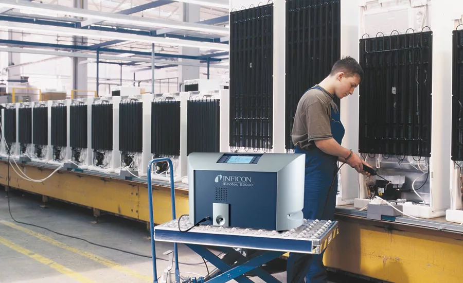

Today, there are three basic methods for helium leak detection, all of which use a mass spectrometer to identify helium escaping through leaks, typically smaller than 10-3sccs. Most commonly used in the automotive industry are automatic leak test systems, where a part is placed under a vacuum hood, and then charged with helium. Any helium that escapes from the part is identified by the mass spectrometer in the vacuum. Another method is essentially the inverse, where the inside of a part is evacuated, and then helium is sprayed on the outside of the part. A spectrometer inserted into the part identifies if helium enters the workpiece. The third method is a sniffer test, often used in the HVAC industry, in which the gas is sent into the part, and a technician manually uses a sniffer to detect if and where helium escapes.
