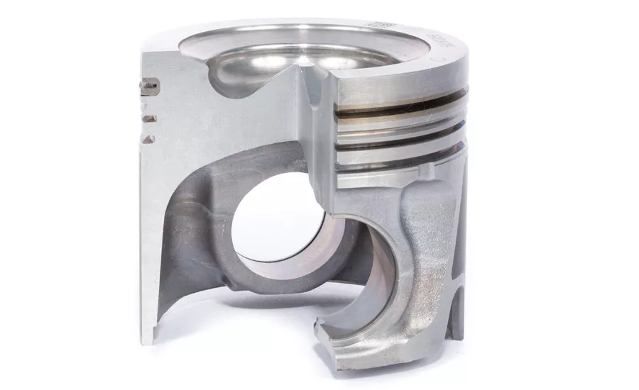

For detection of crack and flaws, it’s important to establish the location of interest and the minimal detectable flaw size that you want to find. Figure 1 shows a cutaway of a piston. For this test, the component manufacturer wanted to look at specific, critical areas in the combustion bowl. The manufacturer specified these locations on a drawing of this component.
Minimum flaw size can be a subjective call. With a flaw detection requirement that is unnecessarily aggressive, the manufacturing line will likely get a significant number of false rejects. Once the minimum flaw size is specified, sample reject (red rabbit) parts are machined using conventional or EDM techniques, depending on the flaw requirement.

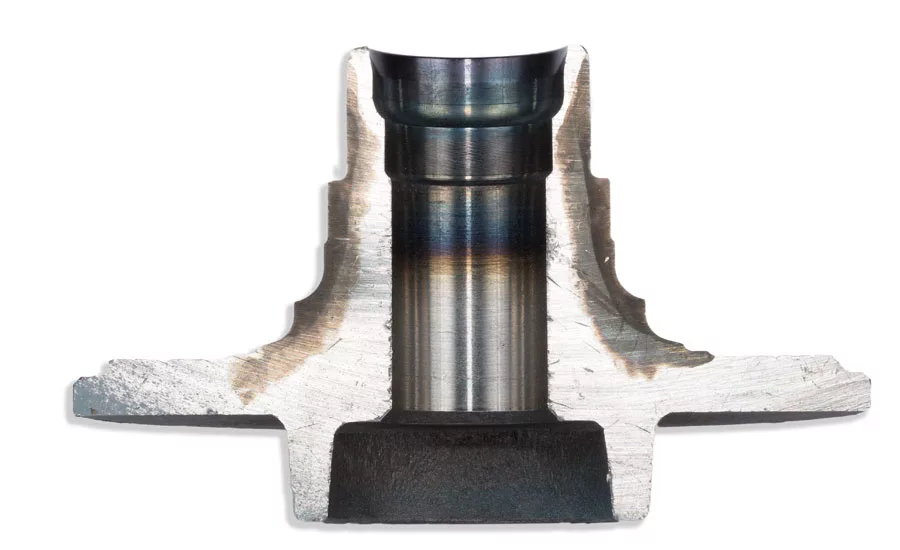

For heat treat validation, it’s also critical to establish minimal acceptance criteria. For a simple part, like a ball or roller bearing, it can be a specific Rockwell standard that must be met. For a complex part, like the cutaway wheel bearing shown in Figure 2, a complex test coil design using multiple sensors that are carefully located is required to check for proper heat treat and case depth patterns.

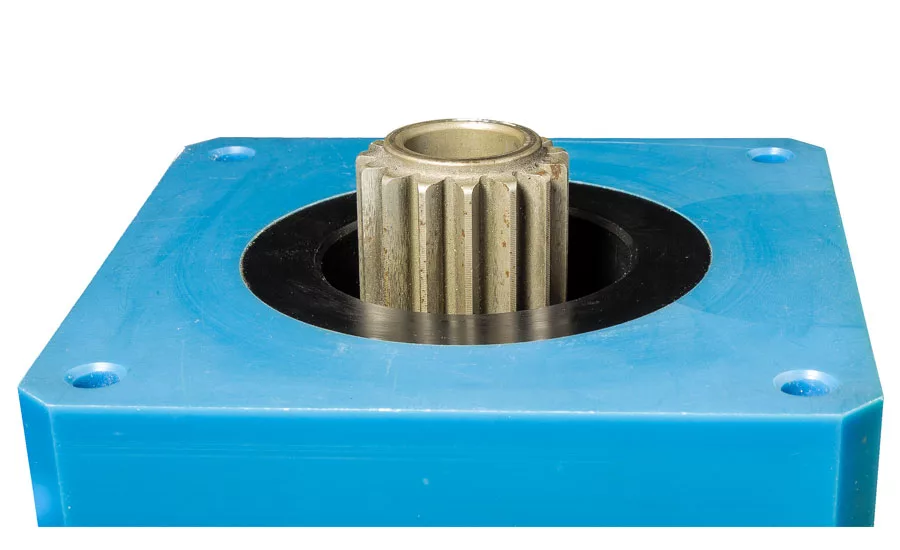

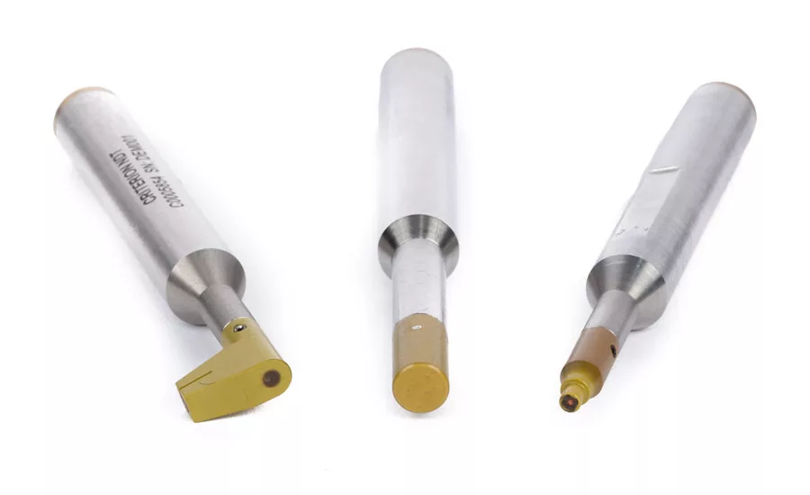

The eddy current testing supplier will then evaluate whether standard eddy current pencil probes (Figure 3) or standard eddy current encircling probes (Figure 4) can be used for proper evaluation. If not, eddy current probe bodies can now be quickly built using a 3D printer (Figure 5). Prototype coil impedances are calculated and coils are custom wound specifically for the test (Figure 6).

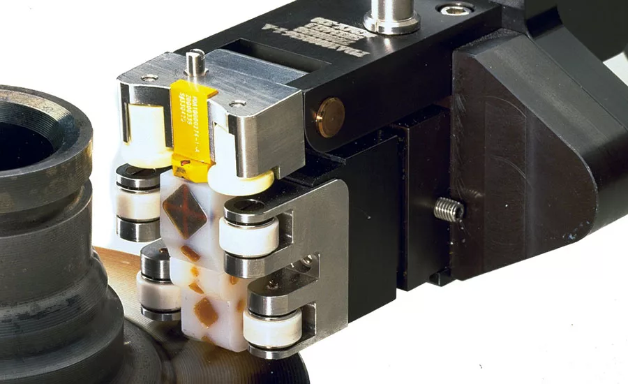

An example of a production fixture probe can be seen in Figure 7. This probe is designed to simultaneously test eight areas on an automotive wheel bearing component.
Production-ready eddy current systems must have the ability to interface directly with industrial automation systems, or alternatively, via PLCs. The eddy current instrument I/O must be able to communicate with the industrial automation system for part loading, when the test is taking place, and when the test is over. It must also communicate where the component has tested positive to send it to the next production station, or send it to a reject chute if the component fails the test.
The material handling system for the probe shown in Figure 7 locates the bearing into near proximity with the eddy current probe. It must then move the probe to engage with the bearing. The system then spins the bearing to ensure full coverage of the circumference. I/O signals to the eddy current instrument initiate and then disable the test. Once complete, the system sends a command to retract the probe and sends the part onto the rest of the line, or moves it to a reject area, depending on the outcome of the test.
