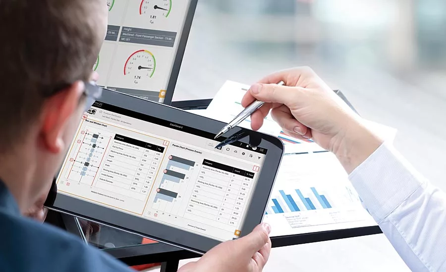

Quality teams and executives view enterprise-wide data aggregated into dashboards and charts to spot trends across operations. Subsequent adjustments can improve efficiency, productivity, and yield, while exponentially increasing cost savings.  Source: InfinityQS
