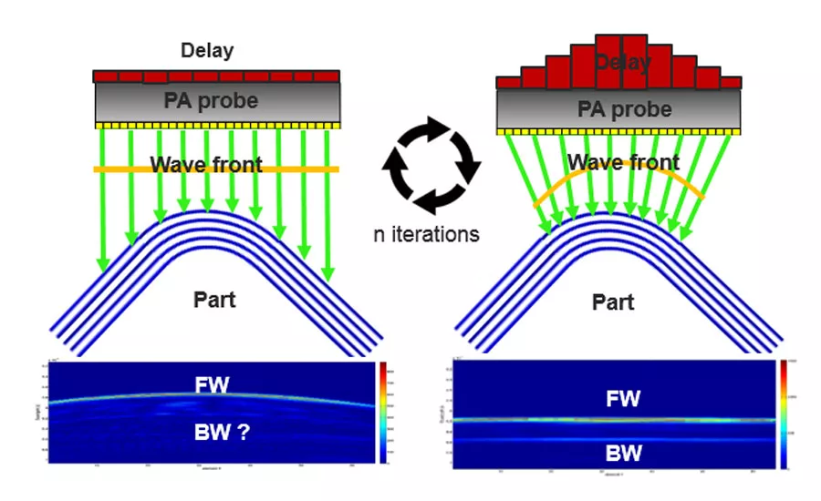

The process of adaptive ultrasound.
The process of adaptive ultrasound. On the left, the front wall of the component appears as a curve; the back wall is not detected, showing that the part was not properly inspected. On the right, after multiple iterations, the beams are corrected in such a way that the front wall is a line and the back wall is properly detected. As a result, all indications located in the component can be properly detected.

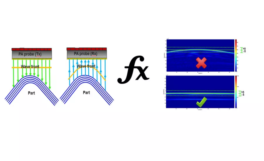

The three steps of the adaptive process
The three steps of the adaptive process.

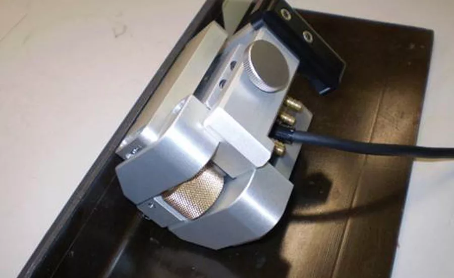

L-shape component inspection.

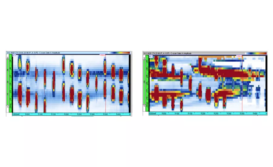

Inspecting uniform varying radiuses with (left) and without (right) adaptive focusing.

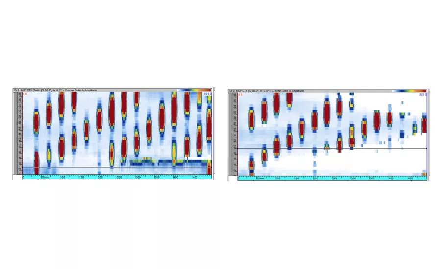

Inspecting non-uniform (weighted) varying radiuses with (left) and without (right) adaptive focusing.

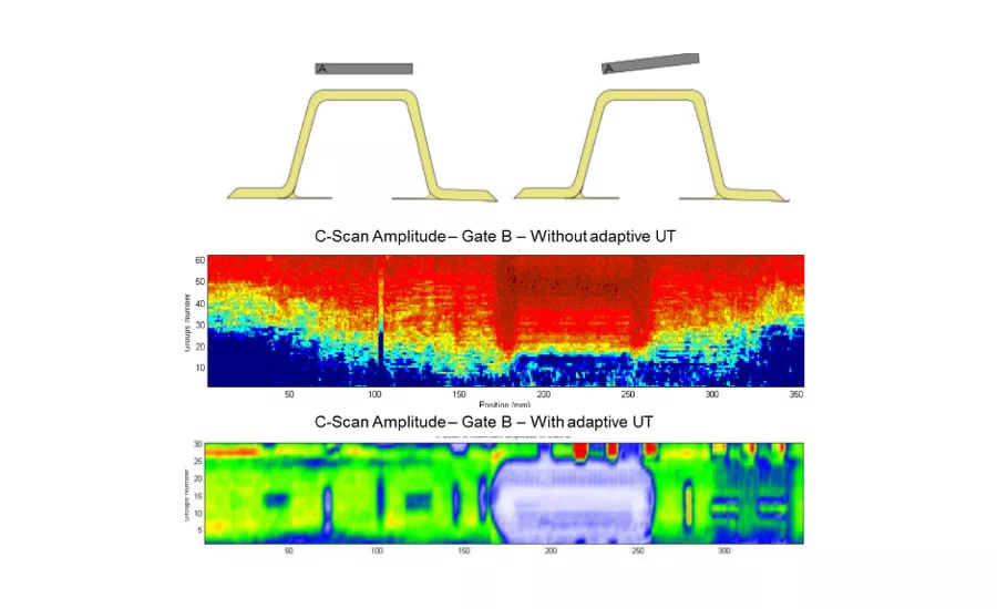

Misalignment with (bottom) and without (center) adaptive focusing.

Adaptive ultrasound enables the transmission of a wave front parallel to the surface of a part with complex geometry. The adaptive ultrasound process can be divided into three steps. First, a plane wave is transmitted using all available elements on the phased array probe, and the elementary A-scans are recorded. The second step is an iterative process that adapts the front wave to the geometry of the part. This process adjusts the delays for each transmission event until a convergence criterion, based on the time of flight from each element, is reached. Once the convergence criterion is reached, the third step is to generate summary A-scans, just like in a standard phased array inspection, using the elementary A-scan received from the last transmission event.

In this section, we illustrate the benefits of adaptive phased array using three examples. The first two examples were performed on an L-shaped component. The radius of the component was inspected using a 5 MHz curved phased array probe with a local immersion probe holder. In these two examples, the radius of the component varied from 0.2 inch to 0.5 inch over its length, but the first component has a uniform radius and the other has a non-uniform (weighted) radius. Delaminations are embedded in the components at different positions. Scans were performed with and without the adaptive algorithm.
The result shows the C-scan mapping of the components’ radiuses. In both cases, all the delaminations are clearly visible with the adaptive algorithm, while the C-scan without the adaptive method has zones containing undetected flaws.
In the third example, a 5 MHz linear array probe was intentionally misaligned. The test was performed in an immersion tank. We can see the effect of a misaligned phased array probe, while the C-scan obtained using the adaptive method corrected the beams, enabling the components to be properly inspected.
