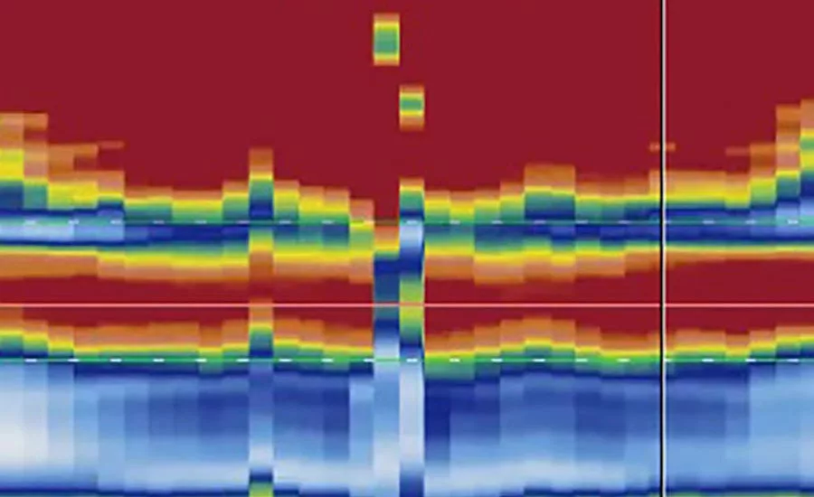

Unlike single element traditional ultrasound, phased array technology uses a 3” wide array with 128 small transducers that are electronically pulsed together to make multiple sound beams covering an area of several inches. This allows the entire weld area to be covered without any mechanical movement. Utilizing phased array technology with a water gap between the array and the pipe allows the outer diameter to be monitored by measuring the change in the water path, while also monitoring the inner diameter by measuring the pipe thickness. The ability of phased array to electronically scan the length of the array results in several advantages:
  1. No mechanical movement of the transducer results in simpler mechanics without the need for maintenance or operator intervention.
  2. Measuring the outer diameter and inner diameter with the same sound beam allows the measurements to be displayed with easy to interpret images showing a cross sectional view of the weld dimensions. The operator is quickly notified of a broken tool or a tool that is cutting too deep or not deep enough to make a smooth transition with the parent material.
  3. High-speed phased array inspection can achieve thousands of measurements per second ensuring that the weld profile is 100% covered. Additionally, the same measurement that is monitoring the weld seam can test for lamination defects in the heat-affected zone. Performing this test with a single element oscillating transducer would result in poor coverage leaving most of the weld not inspected.
Echomac
Echomac® PA TW screen for identifying defects in welded tube. Data is shown in concise manner using C-scan and summed A-scans for signals that cross the threshold for thickness variation and defect detection. A live B-scan view is also presented that allows the operator to easily align the system with the current weld position. Source: Magnetic Analysis Corporation
