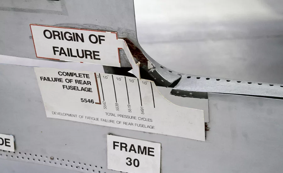

The de Havilland DH 106 Comet
Figure 1 – The de Havilland DH 106 Comet was the world’s first commercial airliner and featured a pressurized cabin designed for transatlantic flights. In 1954, approximately a year and a half after entering service three Comets broke up mid-flight resulting in the loss of passenger and crew. Following the accidents, the forward fuselage was tested for metal fatigue by repeatedly pressurizing the cabin in a water tank. The pressurized cycle tests identified locations of high stress at the corners of the windows due to their square shape. In order to minimize the stress concentrations in these regions, the plane's designers made the windows more round or oval. (Maurice Savage / Alamy Stock Photo)

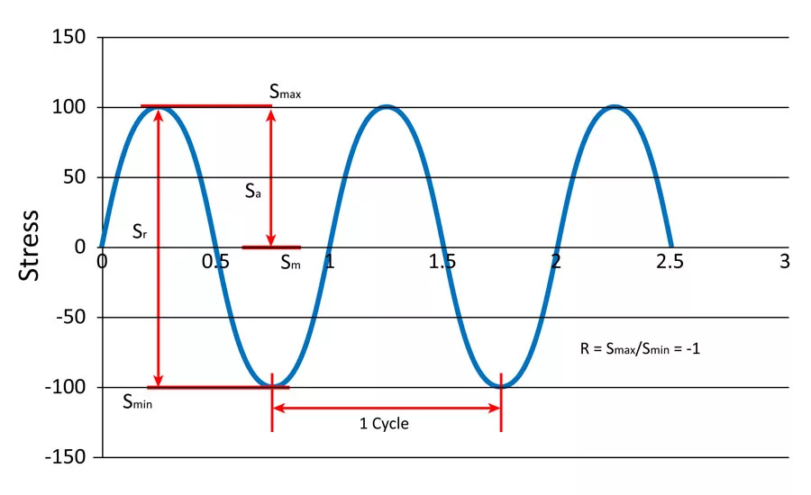

Figure 2 - Fully Reversed Stress Based Cycle

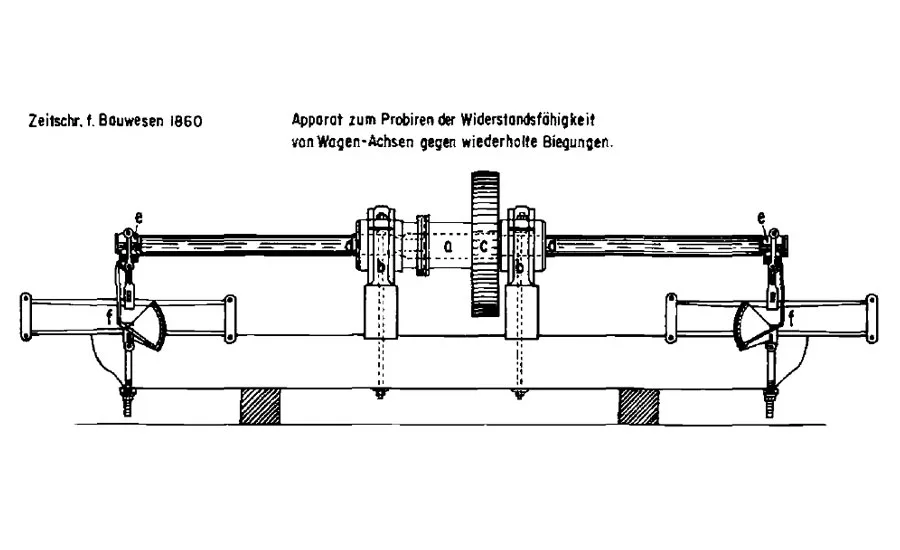

Figure 4 – Wohler’s Fatigue Testing Machine (2).
Figure 4 – Wohler’s Fatigue Testing Machine (2). A spindle (a) in the center of the machine is supported by two bearing blocks (b) and rotated at approximately 15 rpm. Two axles (test specimens) were mounted to both ends of the rotating spindle and bending forces were applied to the axles through a spring mechanism (f) located at both ends of the machine. During each revolution, both axles were subjected to a fully reversed bending stress. The magnitude of the bending stress was adjusted by the tension in the spring mechanism.

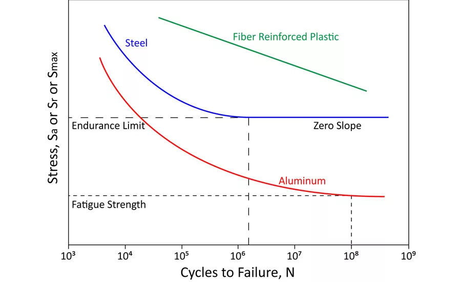

Figure 6 - S-N diagrams for steel, aluminum and fiber reinforced plastic.

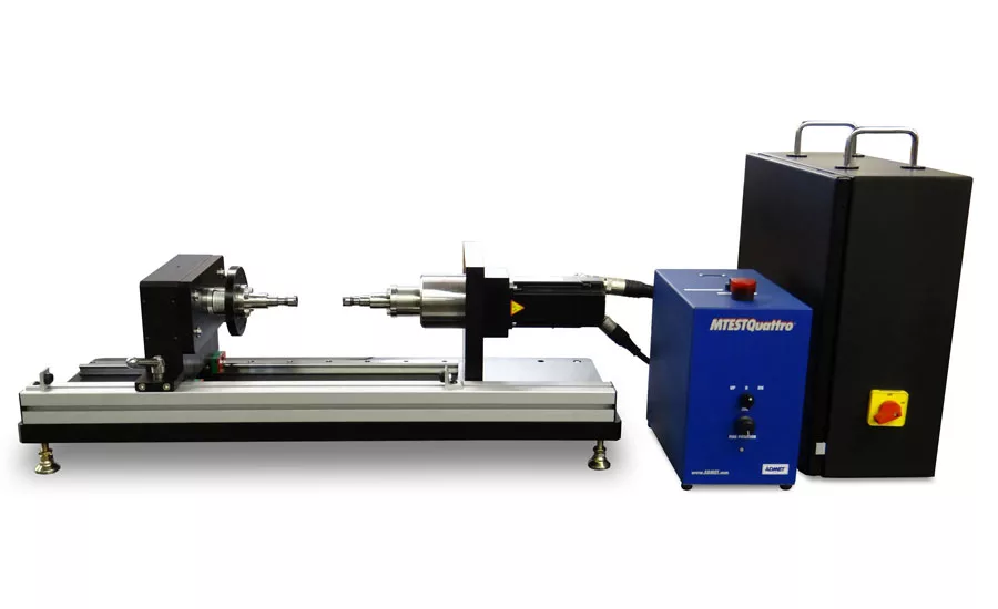

Figure 7- Ducom Instruments rotating bar bending fatigue testing machine.
Figure 7- Ducom Instruments rotating bar bending fatigue testing machine. A test piece mounted as a cantilever with single point loading is made to rotate and thus subjected to a bending moment. Principle is similar to Wohler’s machine built in the 1800s. Courtesy of Ducom Instruments

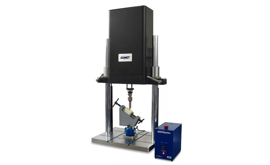

Figure 8 –This fatigue testing system is configured for testing dental implants
Figure 8 –This fatigue testing system is configured for testing dental implants according to ISO 14801 Dentistry Implants – Dynamic Fatigue Test for Endosseous Dental Implants. Source: ADMET

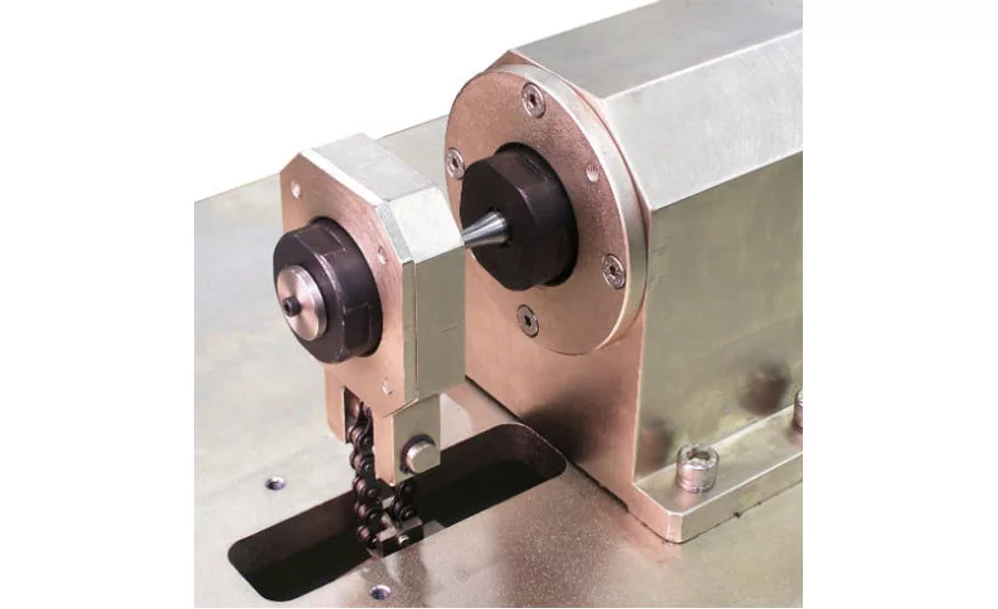

Figure 9 – A Torsion Fatigue Testing System
Figure 9 – A Torsion Fatigue Testing System configured for performing fatigue tests on small components used in portable electronic equipment Source: ADMET

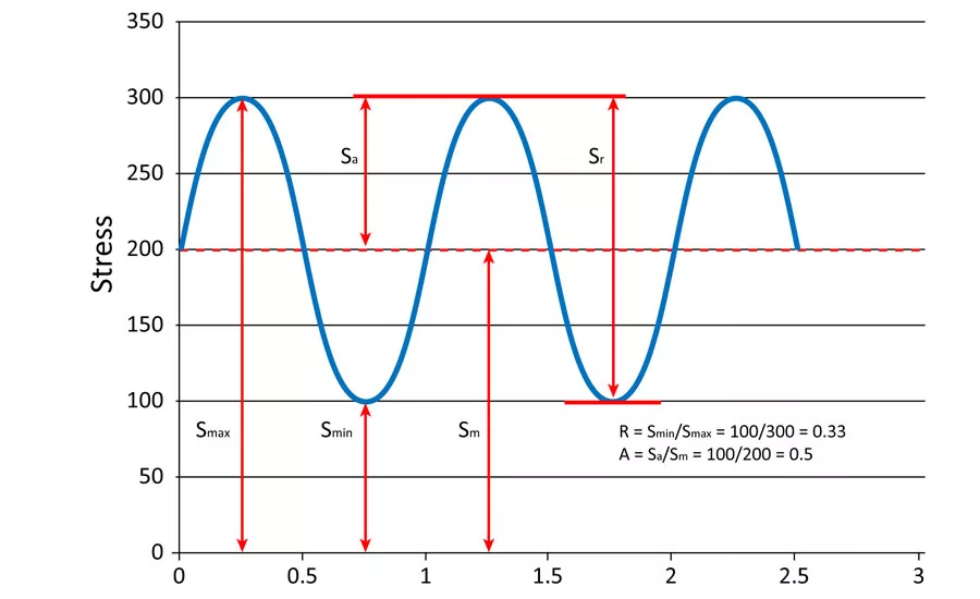

The following definitions and equations are used to express a stress based waveform. (Refer to Figures 2 and 3 for further explanation.)
Stress Range, Sr, - difference between the maximum and minimum stress.
                                                           Sr = Smax - Smin
where, Smax = Maximum Stress
Smin = Minimum Stress
Stress Amplitude, Sa - one half of the Stress Range, Sr.
                                                           Sa = Sr/2 = (Smax-Smin)/2
Mean Stress, Sm- average of the maximum and minimum stress.
Sm = (Smax + Smin)/2
Stress Ratio, R – equals -1 for fully reversed loading.
                                                           R = Smin/Smax
Amplitude Ratio, A – infinite for fully reversed loading.
                                                           A = Sa/Sm = (1-R) / (1+R)

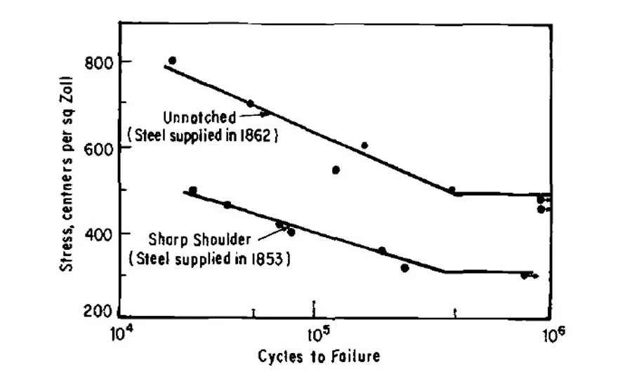

Between 1852 and 1870, the first systematic fatigue tests were carried out on specifically designed laboratory specimens by August Wohler, a German railway engineer. These tests enabled Wohler to relate his experimental results to the stresses in locomotive axles. In 1870, Wohler compiled a report of his experimental work which contained several conclusions known as Wohler’s laws.
Wohler’s Laws (1)
Materials can be induced to fail by many repetitions of stress, all of which are lower than the static strength.
Stress amplitudes (or stress range) are decisive for the destruction of the cohesion of the material.
The maximum stress is of influence only in so far as the higher it is, the lower are the stress amplitudes (or stress ranges) which lead to failure. This translates to increasing the mean stress decreases the number of cycles to failure.
Stress life testing is based on Wohler’s work and requires multiple constant amplitude fatigue tests on identical samples to generate an S-N or Wohler diagram. Figures 4 and 5 are diagrams of Wohler’s fatigue testing machine and the S-N diagrams for the steel used in the axels, respectively (2). Stress life testing is the most common type of fatigue testing and is designed to determine the safe or infinite life or fatigue strength of a material or component.
The S-N or Wohler Diagram
In stress based fatigue tests, multiple samples of identical size, shape and composition are subjected to different levels of stress amplitude, Sa, or stress range, Sr, and the number of cycles to failure, N, is measured for each. Various types of instruments and machines are used to apply cyclic loading and include rotating bend and cantilever bend machines (Figure 7), servo-hydraulic or servo-electric axial push-pull testing systems (Figure 8), and electric motor driven torsion fatigue testers (Figure 9). The resulting S-N data for each identical specimen is plotted on either a log-log or semi log graph. Regression is used to fit a curve through the points resulting in an S-N diagram as shown in Figure 6. Depending on the type of cyclic loading the ordinate (y-axis) will represent stress amplitude, Sa, stress range, Sr, or maximum stress, Smax.
The S-N diagram for some materials including steel and titanium transitions to a zero slope at a particular stress level. As shown in Figure 6, the point at which the slope transitions to zero is referred to as the endurance limit. Materials subjected to stresses below the endurance limit will never fail under cyclic loading. The portion of the curve with negative slope is defined as the finite life region and the horizontal or zero slope portion of the curve is the infinite life region.
Many non-ferrous alloys such as aluminum and copper and composites such as fiber reinforced plastic exhibit an S-N diagram with negative slope only. Negative slope S-N diagrams have no definite endurance limit (see the aluminum S-N diagram in Figure 6). Materials exhibiting S-N diagrams without a definite endurance limit, report fatigue strength as a stress below which failure will not be expected in less than a specified number of cycles. The fatigue strength or effective endurance limit for these materials is sometimes defined as the stress that causes failure at a specified number of cycles (i.e. 108).
