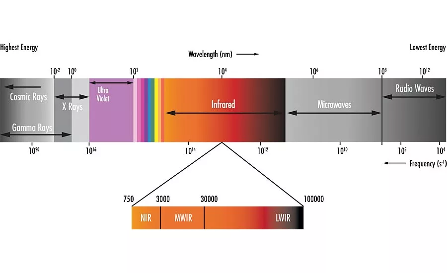

The Electromagnetic Spectrum
Light is a form of electromagnetic radiation, where linked electric and magnetic fields vary at a given frequency, which implies a given wavelength as well. That is, light of a specific frequency also has a specific wavelength, so knowing one of those values determines the other. Electromagnetic radiation travels at the speed of light, and the range of possible wavelengths is somewhat arbitrarily divided into different regions. Wavelength is often represented by the symbol lambda (l).
The longest wavelengths are grouped under the term “radio waves,” while the shortest are referred to as “gamma rays.” In between we have x-rays, ultraviolet, visible, and infrared. To some purists, “light” refers only to the very narrow region of the electromagnetic spectrum that is visible to the human eye. Most people, however, extend the term to include ultraviolet light and at least some portion of the infrared spectrum. Wavelengths of light are commonly measured in nanometers (10-9 meters, abbreviated nm) or micrometers (10-6 meters, µm). You’ll also hear micrometers referred to as microns (µ).
Figure 1 introduces some of the spectral regions of electromagnetic radiation defined by the ISO. Ultraviolet (UV) rays are commonly defined as between 1 and 400 nm. Visible light consists of the colors we see, at wavelengths between 400 and 750 nm. Infrared (IR) radiation, between 750 nm and 1000 µm, is often further divided into near-infrared (750 nm – 3 µm), mid-wave infrared (3 – 30 µm) and far-infrared (30 – 1000 µm)—this last increasingly being referred to as the “terahertz region.”
Each region of the spectrum has unique properties, interacting with materials in different ways. A lens that works perfectly for visible light, for example, is unlikely to be transparent to most ultraviolet and infrared radiation.

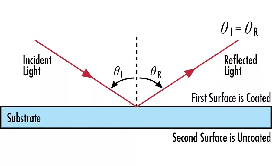

Reflection
The reflection of light from a surface follows a very well-defined rule. The law of reflection states that the angle at which light will bounce off a reflective surface is equal in magnitude to the angle at which it hit the surface. More formally, as shown in Figure 2, the angle of incidence is equal to the angle of reflection. Figure 2 illustrates reflection from a first surface mirror—a material with a reflective surface, either because the bulk material is reflective or because it had a reflective coating deposited on it. For a smooth reflecting surface the reflected light will all come off at the same angle. That’s called specular or regular reflection. If the surface is rough, the reflected rays will scatter; this is referred to as diffuse, or irregular, reflection.

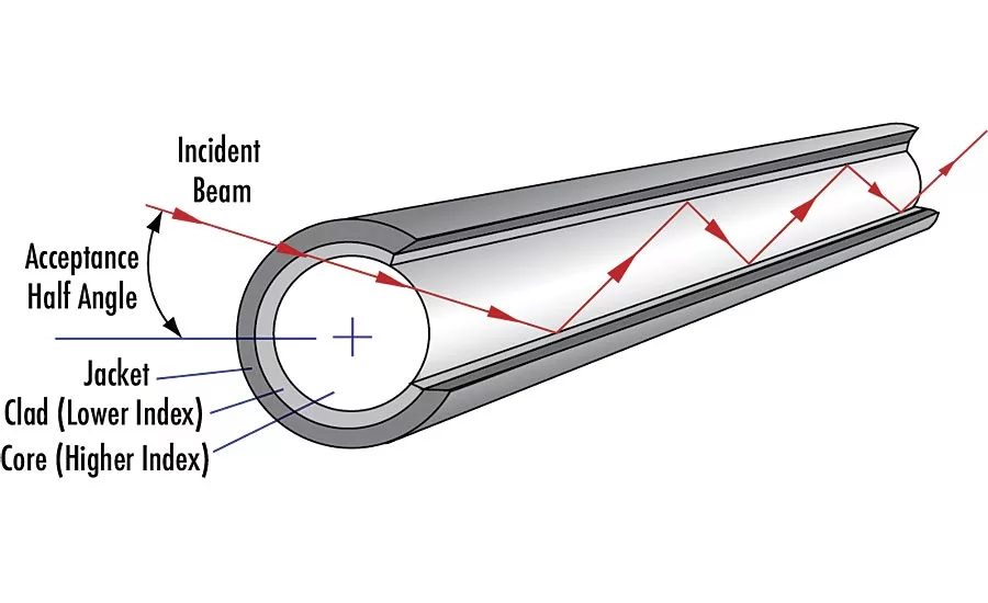

When light refracts from a high-index medium to a lower index medium, it’s possible that the angle of incidence can become large enough that the angle of refraction reaches 90°. At that incident angle, called the critical angle, light reflects back off the interface of the higher index material in a phenomenon called total internal reflection (TIR). As shown in Figure 4, total internal reflection is responsible for the propagation of light through optical fibers.
