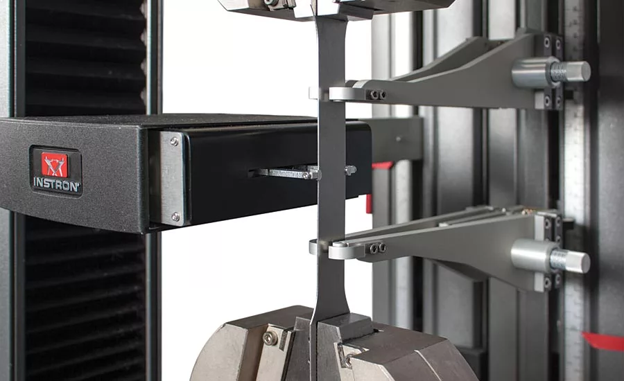

Testing sheet metallic material
Figure 1: Testing sheet metallic material using an axial and transverse extensometer to determine plastic strain ratio (r-value). Source: Instron

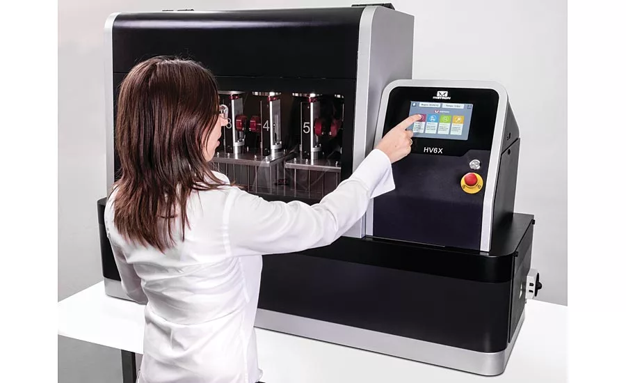

Testing HDT & Vicat on a system
Figure 2: Testing HDT & Vicat on a system with automated station lifting and automated weight application. Source: Instron

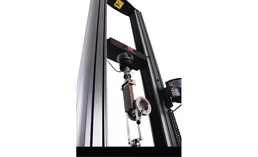

Testing composite materials with climbing drum test fixture.
Figure 3: Testing composite materials with climbing drum test fixture. Source: Instron

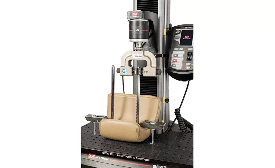

Testing of full components
Figure 4: Testing of full components on a universal testing machine fitted with a tapped table test plate. Source: Instron

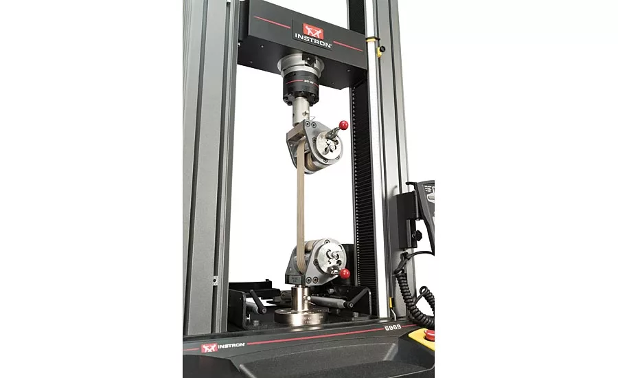

Figure 5: Testing seatbelt materials using capstan principle gripping solution. Source: Instron

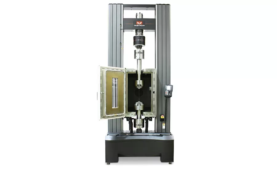

Testing within an environmental chamber
Figure 6: Testing within an environmental chamber capable of low and high temperature testing. Source: Instron

With the majority of the structure of a car still being produced in various metals, there is a huge opportunity to lightweight the vehicles by optimizing the metals used. New generation high-strength steels are being developed and produced to maintain the automotive industry’s demand for steel.
Despite this, automotive manufacturers are now working with aluminum producers more and more to increase the percentage of aluminum used in the production of automobiles. Aluminum offers low density, excellent formability, corrosion resistance and now comparable strength with ferrous materials.
The advantage of using metallic materials for the production of automobiles is that most are more or less isotropic and homogenous. This means their properties are theoretically uniform, independent of its direction. This is hugely advantageous for mechanical testing, as it means performing a uniaxial tensile test can allow for calculations of most mechanical properties. Traditionally, there has been a tradeoff between strength and formability; now, metal producers are releasing higher grades of sheet metal where the reduction in formability is minimal despite considerable strength gains. Typical calculations required include yield strength, ultimate tensile strength, elongations, and plastic strain ratio (r-value), and strain hardening exponent (n-value). R and n values are critical mechanical properties that define the formability of these products.

Characterization of polymer properties is critical in the development and manufacturing processes of materials, as well as in quality control and in determining the functionality of a finished product. Polymers are utilized in almost all parts of a vehicle’s construction, and today, because of its increased strength, it has been advantageous to use in sections of an automobile that once were metal, including body panels. It is crucial to understand these properties as a polymer material moves through its lifecycle of raw material to compound to semi-finished to finished product.
Although several materials or parts may be developed in parallel, changes to one part, whether it is material or design related, may result in having to re-evaluate many other parts, even those being developed by other companies. In the case of plastics, the new material could have a different shrinkage factor, which could change the overall size of the part and this could lead to “fit and finish” issues with nearby components. Also, the harmonization of materials is critical to keeping the cost down, which incentivizes manufactures to limit the number of materials used. Fewer materials simplify manufacturing, providing more buying power and resulting in less suppliers. For these reasons, it is advantageous to get it right the first time, which a range of mechanical testing can help to identify.

Composite material can offer the greatest potential to reducing the mass of vehicles. Unlike metals, the materials formed are typically anisotropic, meaning that the material properties are dependent on the direction. This offers great benefits as engineers can design components by putting the strength where they need it and in the axis where it is most critical. However, very few assumptions or constants can be taken from one test, meaning there is a much larger spread of testing requirements. For instance, to determine the static bulk properties of a composite requires tension, compression and shear tests. Other tests need to be conducted to determine the inhomogeneity of the material, such as interlaminar fracture toughness, which measures the material’s resistance to delamination.

Testing the performance of components, whether in its physical strength or in its operation, is critical to many automotive suppliers in a quality control aspect, but is also hugely important for research and development of new products. This can be challenging as not many components being tested are similar, and therefore require specific fixturing for the individual component. Ensuring that these fixtures are centered and secured in the same place is crucial to getting repeatable results. T-slots bases are commonly used on universal testing machines to secure fixtures; however, these can be difficult to secure in exactly the same place. The recommended solution would be to use a tapped test plate—an accessory that ensures the fixtures are secured, allowing for improved repeatability.
Some components need to be tested in a way that simulates the use of the product or component. To do this you may need to create a loading profile in the testing software. Whether controlling is based on force feedback or movement, it may be important to load and unload in a specific cycle and create calculations or exports based on the results at each ramp.

The most critical safety feature for a passenger is a seatbelt. Seatbelts are tested to ensure that a passenger is kept safe at substantial G forces in the case of an accident and must be suitably strong and elongate enough to slow a person down without causing additional injury. Webbing matrices of seatbelts are extremely challenging to test with traditional gripping solutions and instead rely on grips utilizing the capstan principle to ensure accurate and repeatable results.

With all of the testing requirements stated so far, it is also critical that these properties can be determined within the operating range of the vehicle. Ambient testing is most common; however, testing at sub-ambient and at above ambient temperatures will be need to be done to ensure that the product will not fail in different conditions or regions of the world.
