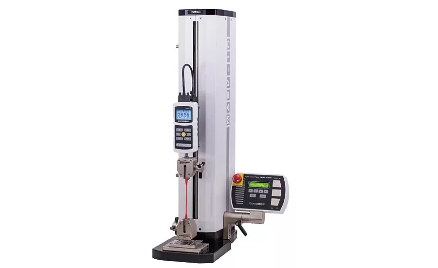

One of the main tools in the quality toolbox is tensile testing. In tensile testing, a sample is subjected to a pull force. The test objectives vary from application to application, and can include measuring the breaking force, the force at a pre-defined elongation, elongation at break, as well as some scientific calculations, such as Young’s modulus. Test results can inform the designer or quality control engineer whether the material or sample has been designed and manufactured appropriately. But, as with any testing, the data is only as good as the test methodology allows.
Poorly conducted tests are detrimental to a quality program. Here are five common errors in tensile testing, and ways to correct them:

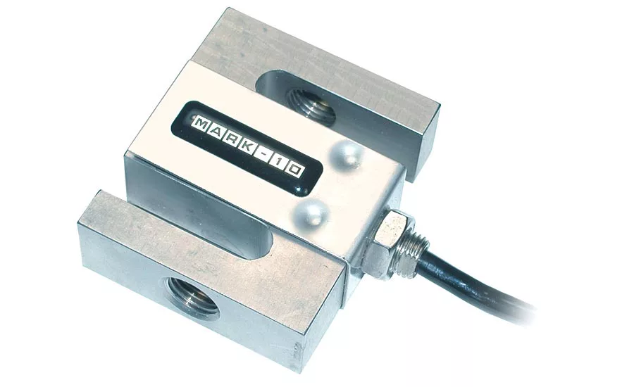

1. Wrong load cell capacity
The accuracy of load cells used with tensile testing machines is normally rated in one of two ways: 1. Percentage of full scale, or 2. Percentage of reading.
In percentage of full scale, a percentage equates to a fixed error that may be present anywhere from zero load to the full range of the load cell. In percentage of reading, the measured value is multiplied by the accuracy specification. A lower bound is sometimes specified in this method. For example, a load cell may be rated to a particular percentage of reading only from 10% of range up to 100%.
In both methods, using a load cell at the lower end of its capacity can produce a large error relative to the magnitude of the force being measured. Using a significantly oversized load cell can render the tensile measurement worthless, because uncertainty in the reading may be as high as the reading itself. Using the example of a 1,000 lbF capacity load cell and an accuracy of ±0.50% of full scale, an error of up to ±5 lbF can be expected. If this load cell is used to measure only 5 lbF, a 5 lbF error represents 100%, which is clearly unacceptable.
Corrective action
Manufacturers want to get the most utility out of a piece of equipment, thereby minimizing capital expenditures. However, before attempting to use a load cell it would be wise to determine the tolerance specification and compare that to the expected forces. Then, decide on an acceptable tolerance range, and determine whether it will be possible to measure forces within the defined criteria.

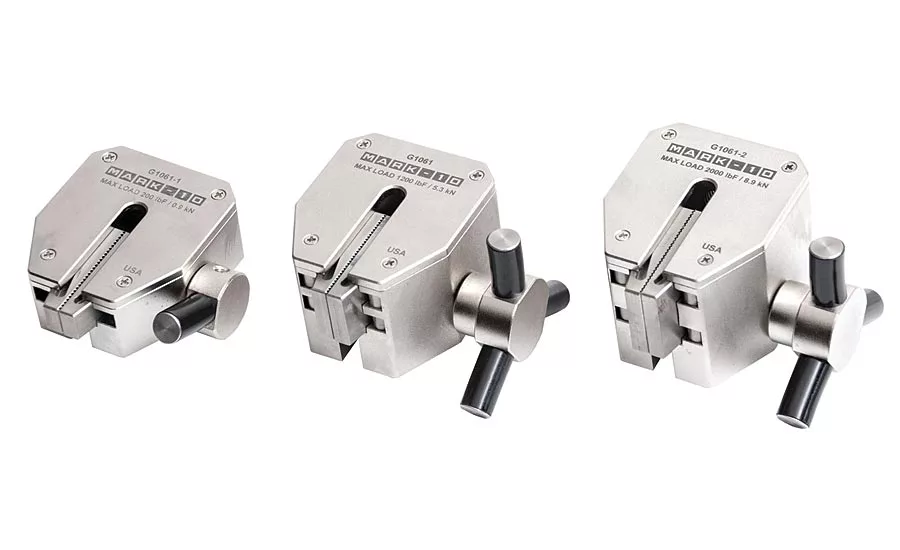

2. Using the wrong grip
In sports, the grip is the point where the athlete and the sport interface. Many a golf pro has solved a problem by adjusting their student’s grip. Similarly, recall the Deflategate football under-inflation scandal, which ostensibly originated with a desire for the team to make more completions via better grip with the football.
Tensile testing is no different. The grip is where the sample and the test equipment interface. Selecting the right grip can be as important as selecting the right tensile tester and load cell range. When measuring elongation, for example, if the grip is not able to secure the product properly, slippage will produce an erroneously high travel measurement. This measurement would be of little worth, and potentially damaging if it’s relied upon to make product design decisions.
Another angle to consider is the ability of a grip to allow for visual inspection before, during, and after testing. If the sample is obscured, it may be difficult to ensure that it is loaded properly.
Corrective action
Numerous standard grips are available to accommodate a wide range of applications. Reviewing the application with a tensile testing specialist, and submitting samples for testing by a lab or the tensile tester manufacturer can help determine the best gripping solution. When no standard solution is available, custom grips may be required.

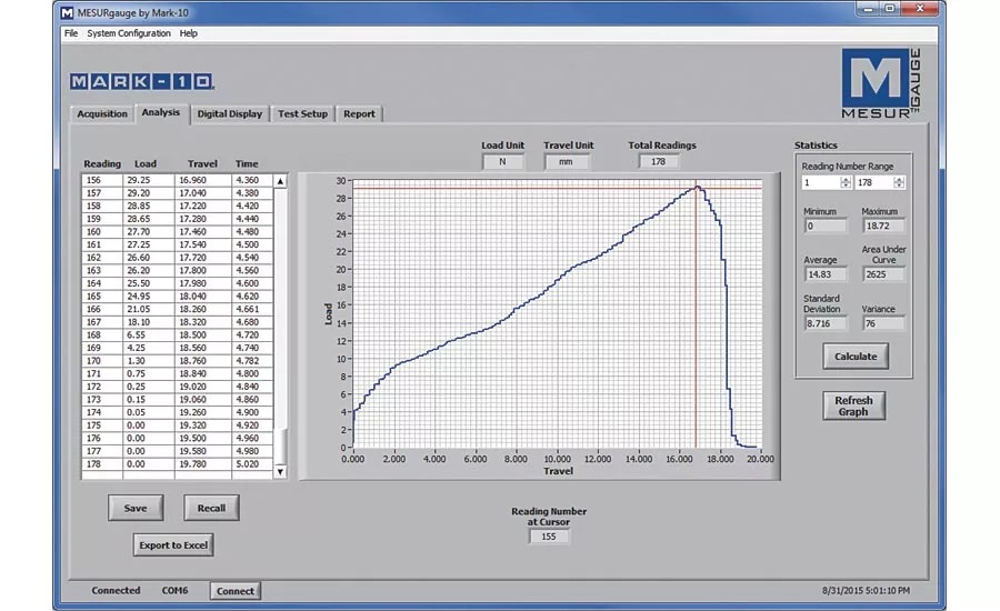

5. Uncompensated system deflection
Travel measurements, required in stress-strain curves, elongation, and most other tensile tests, are subject to errors due to system deflection. These offsets originate from both the load cell and the test frame. Strain gage-based load cells, by their nature, deflect slightly as a load is applied. A typical range is approximately 0.010” (0.25 mm) at full scale. The test frame itself will also deflect under load. Deflection may or may not be linear, depending on the geometry of the load cell and the test frame.
To put things into perspective, if a sample deflects by 0.100” and an uncompensated offset of 0.030” is present, the resulting travel measurement will have an error of 30%, with potentially larger effects on the force measurement. With more elastic materials, an offset of 0.030” would be less of a concern.
Corrective action
Some tensile testers have built-in compensation routines, automatically correcting travel measurements. For testers without automatic compensation, the results should be manually adjusted.
