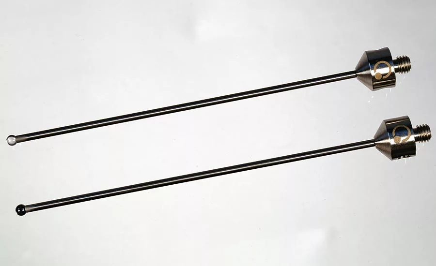

“How do I probe this?” is a question frequently asked by CMM operators and machinists when faced with unusual workpiece features or properties. Often, a traditional ruby ball, carbide stem, and threaded base stylus won’t work. The solution is a special stylus. This article is an overview of some special styli that make up an important part of a CMM or machine tool toolbox.

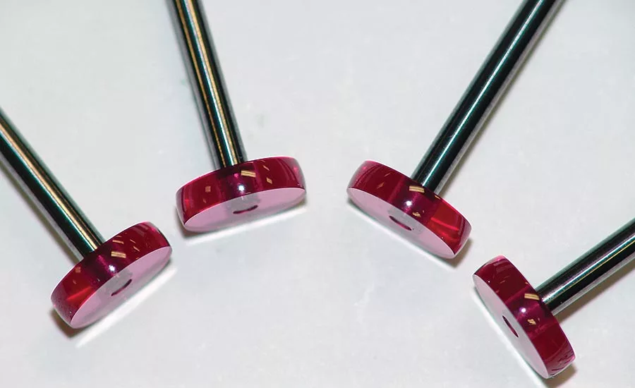

Disk styli
For internal diameters, especially ID grooves
Disk styli are used to probe interior grooves. Hydraulic component manufacturers depend on disk probes to check interior O-ring grooves. The fascinating thing about disk probes is that there are seemingly no two alike. As part geometry varies, so do disk stylus dimensions.
Disk Styli
Disk Styli.
Disk styli typically start as a sphere with the desired edge radius. The sphere is machined on opposite sides to the proper thickness. Finally, a center through hole is added for mounting to a stem. Disk styli are manufactured out of a wide range of hard materials such as ruby, ceramic, hardened steel, and carbide.
We’re frequently asked “How do I calibrate a disk stylus?” The answer is to touch numerous points around the disk surface. A minimum of twelve points should be touched: four around the equator, and eight more distributed widely around the remaining spherical area. Check the calibration results carefully to be certain that the calculated radius is very close to the nominal radius, and that the standard deviation is within limits. If needed, requalify using more touch points until satisfactory results are achieved.

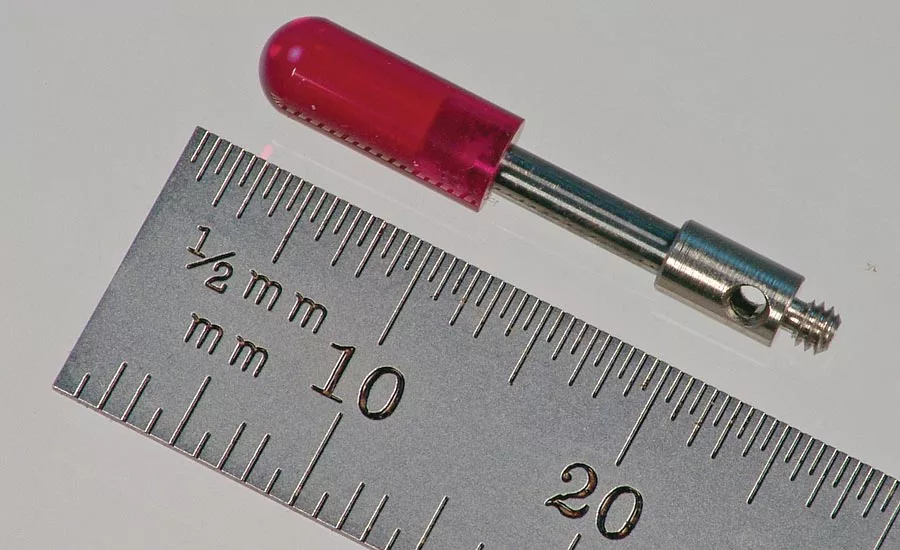

Cylinder styli
For edge measurements
Cylinder styli are often used to probe the edges of thin workpieces, like sheet metal and metal stampings. The tip of cylinder styli may be flat or hemispherical. The hemisphere may resemble a full radius but it is limited in its sphericity. It is a common misconception that the hemispherical tip of a cylinder stylus can be used for precise measurements. Not so. Due to the nature of the manufacturing process, a cylinder stylus’s hemispherical tip is not on par with spherical styli.
Cylinder Styli
Cylinder Styli.
To calibrate a cylinder stylus, it’s necessary to reduce the calibration sphere coverage angle so that the hemispherical tip of the cylinder stylus is always above the equator of the calibration sphere during the calibration process. We recommend a 150-degree coverage angle. Please note that because the hemispherical tip of a cylinder stylus doesn’t have the same high precision as a spherical (ball) stylus, a higher standard deviation value often occurs during calibration. Cylinder styli are suitable for workpieces with relaxed dimensional tolerances. If high precision is required, always use a spherical stylus, if possible.
After calibrating a cylinder stylus, it’s important to measure a known artifact, like a ring gage, to ensure that the measurement result is within acceptable limits. Proceed only when you are satisfied with the results.

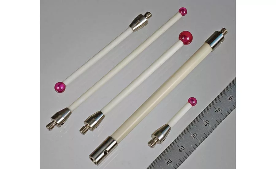

Ceramic stem styli
Designed to break
Styli with ceramic stems have multiple advantages over conventional carbide stems. Ceramic stems are about four times lighter and 10% stiffer than equivalent carbide stems. They are also brittle. Ceramic stem styli are widely used in on-machine probing systems because they break easily in the event of a collision with the workpiece. This advantageous property acts as a mechanical fuse, usually minimizing damage to the probe head and the machine tool. Ceramic stem styli are also used on coordinate measuring machine (CMM) probes as a weight-saving alternative to conventional carbide-stem styli.

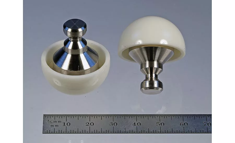

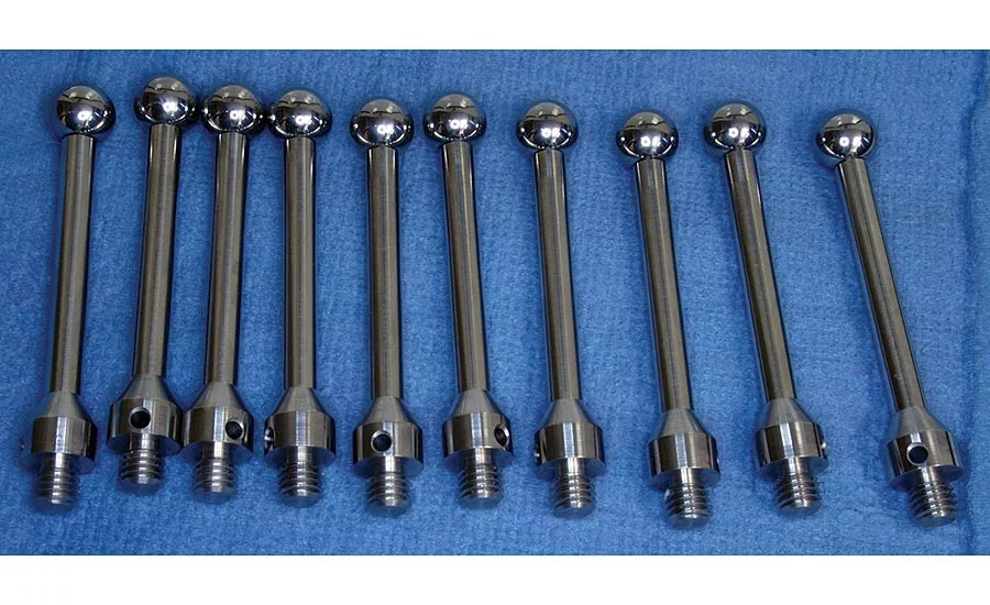

Hemispherical styli
For larger parts and weight savings
It’s good practice to use the largest possible stylus sphere when measuring with a CMM. Large spheres calibrate easily and are less prone to deflection, because they usually have a rigid, large diameter stem. However, as sphere diameters increase, so does their weight. One way to lower weight when using large styli is with a hemispherical stylus. A hemispherical stylus retains the beneficial properties of a large diameter sphere while dramatically reducing its heft.
Hemicpherical Styli
Hemispherical Styli.
Hemispherical styli are made by machining away all but the outer surface of a sphere, while retaining a portion of the interior for mounting to a stem via a threaded insert or a bonding agent. Thus, the user enjoys the advantages of a large diameter sphere without the extra bulk. To save additional weight, the finished stylus can be mounted directly to a carbon fiber extension.

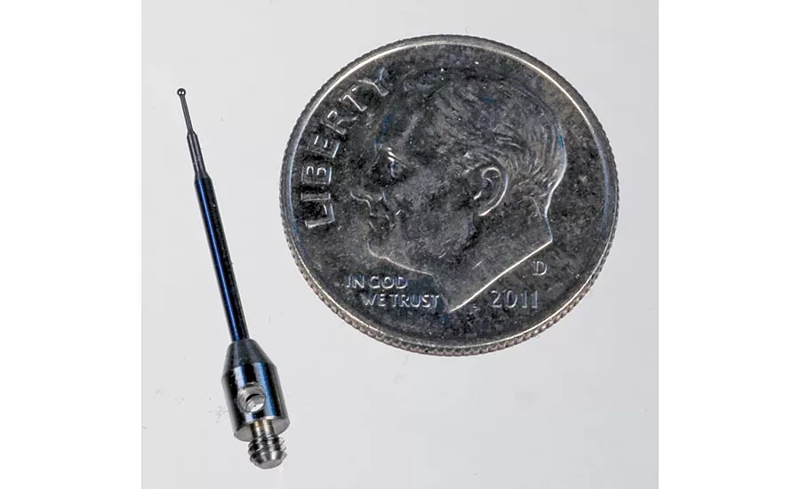

Carbide sphere styli
Useful for small features
Carbide sphere styli, especially in very small diameters of one millimeter and less, are often more robust than ruby sphere styli, largely due to their manufacturing processes. Carbide spheres can be brazed to carbide stems, producing a rigid bond between ball and stem. The strong attachment enhances the stylus’s durability, reducing breakage during handling, calibration, and use. For this reason, many CMM users prefer carbide sphere styli to ruby sphere styli for measuring very small features.

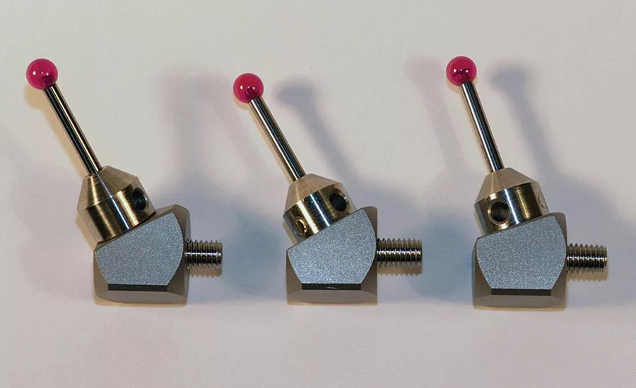

Angled cubes
Easy set-up
While technically not styli, angled cubes are often specified in stylus configurations. Before the advent of angled cubes, adjustable knuckles were commonly used to create angles on which to mount a stylus. While versatile, knuckles add another element to a stylus configuration, increasing the overall weight. They also introduce an opportunity for increased deflection and, therefore, measurement uncertainty. Finally, if a compound angle is required, a single knuckle doesn’t work.
angled cubes
Angled cubes.
On an angled cube, the desired angle, whether single or compound, is machined on one face. A suitable mounting hole is drilled and tapped perpendicular to the angled face. The stylus is attached directly to the angled cube, creating an assembly that is both weight-saving and rigid. Angled cubes can be manufactured from aluminum or titanium. Easy to use, they eliminate guesswork during CMM setup while simultaneously reducing setup time.
Special styli are a vital part of modern metrology. When confronted with a challenging probing issue, users should contact their stylus manufacturer for suggestions. There may be several options. Share your requirements, and let the experts help you choose the most favorable solution.
