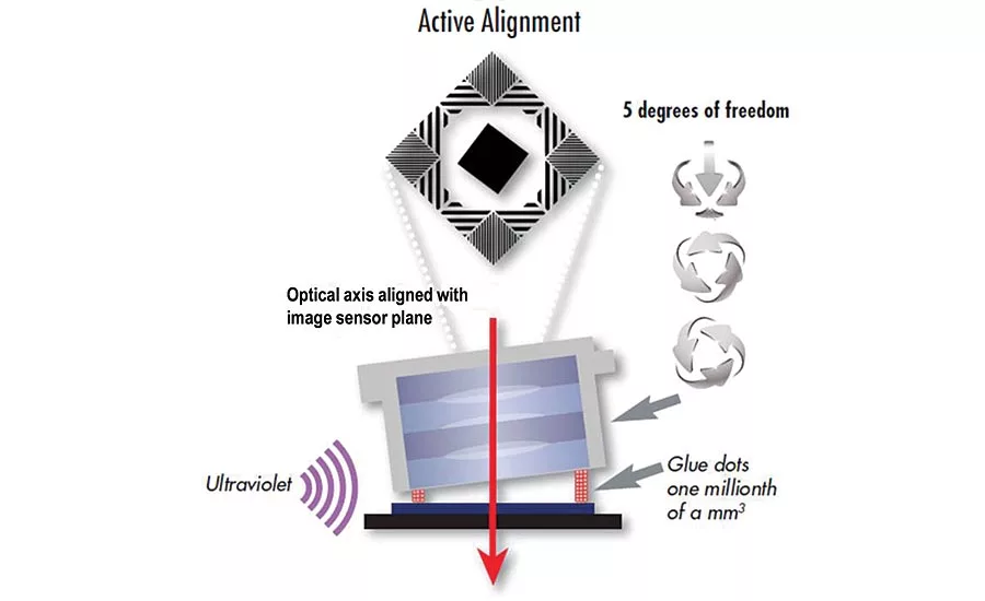

Active alignment of lens/sensor to 5-6° of freedom. Source: AEi

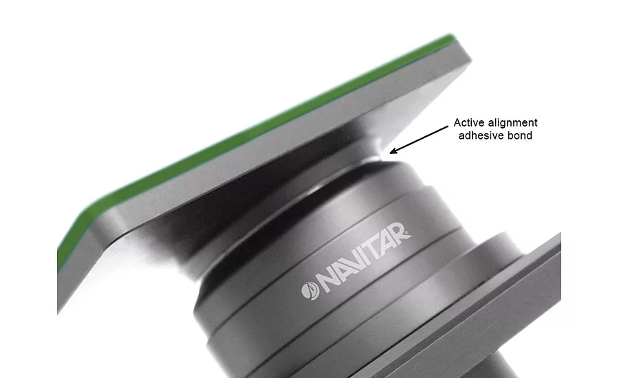

Active alignment adhesive bond of lens to sensor board. Source: Navitar Inc.

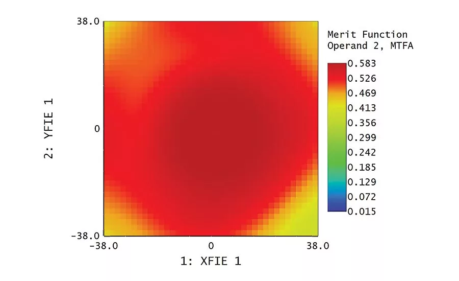

Figure 2. MTF Field Map (145lp/mm) Post Alignment (6 Micron Sensor Runout)

The consumer imaging space is driving the need for better quality, lower cost optical systems. Requirements for high resolution lenses, specifically for use in automotive ADAS systems, have increased the demand for high performance lens/sensor modules. The challenge to consistently produce high quality lens/camera or lens/sensor modules is the ability to optimize focus of the lens to the sensor in six degrees of freedom. This task is difficult to perform manually, requires trained operators, and suffers from the inconsistencies of human inspection.
The solution for the consumer electronics market is the use of automated alignment machines that actively align the lens/sensor combination using algorithms to optimize peak focus as well as tip/tilt of the sensor.

Actively aligning these larger sensors ensures maximum MTF is achieved across the entire field of view with no soft areas of the image (which will degrade the accuracy of image processing algorithms). The process involves loading a large format sensor into the alignment robot and being able to read a live signal from the sensor via electronics in the machine. The lens is plasma treated to remove any surface dirt or oil to achieve the best bond possible. Then a bead of adhesive is applied to the sensor carrier and the lens mechanically moves into position within the focus tolerances predicted during the design. The adhesive choice and post cure characteristics are critical to aligning large optical systems to large sensors because there is significantly more bond area than small, smartphone applications.
The alignment procedure finds best axial focus and then predictively iterates the tip/tilt, rotation and lateral adjustment of the sensor until achieving maximum MTF across the entire sensor. With the sensor in place, the adhesive can be spot cured with UV illumination and then either heat or time cured off-machine.

This MTF map can be significantly improved with active alignment, reducing the residual sensor error by 10x (~50 microns to 10 microns). In Figure 2, the MTF across the entire field exceeds 40% at the Nyquist of the sensor and the MTF across the entire sensor now exceeds 40%. This alignment process is very repeatable and can be performed rapidly in a high production environment.
