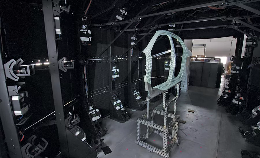

The modular concept allows users to scan a wide variety of parts with a minimal amount of fixtures. Photo of courtesy of Polyrix.
When Jonathan Bouchard, Polyrix Inc. director of sales/business development in Quebec, Canada, needed a fixture to support their scanning cell they looked to modular. “Here’s how we view modular tooling/fixturing,” he says. “Modular tooling is the logical complement to our surround 3D scanning systems. It supports the part with minimal view obstruction, which is crucial for noncontact inspection systems like ours. Using modular fixture on wheels, the operator can simply put the part on a cart, roll it inside our system, press a button and get complete 3D dimensional data in matter of minutes. The modular concepts with adapters allow us and our customers to scan a wide variety of parts with a minimal amount of fixtures. Finally, the possibility of reconfiguring the modular fixture means you can easily adapt to design revisions, which is getting more and more frequent these days.”
