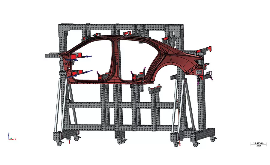

Final CAD rendering of tool with Body part. Source: Paul W. Marino Gages

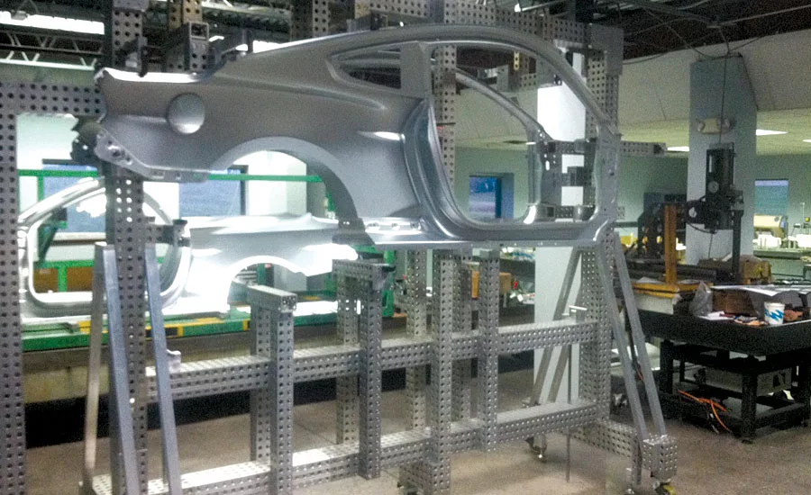

Universal Modular Frame for multi-vehicles.  Source: Paul W. Marino Gages

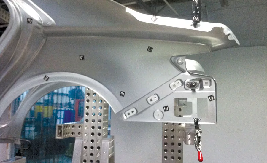

Closeup of locator/clamping detail. Source: Paul W. Marino Gages

A recent large U.S. automotive manufacturer using modular tooling has accomplished all these features adapting tool requirements for moving tools into a measurement cell for a noncontact system. The goal was to save time, cost and utilize the same “frame” to accommodate multiple stampings for multiple vehicles. The material needed to “disappear” so the scanner could see only the parts. A win-win situation and the tools are portable and when they need a next generation it is easily converted.
