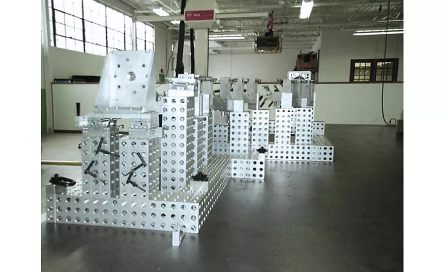

They even make tow trucks to tow those monsters. And when a base vehicle needs a drastic modification the reusability and reconfigurable fixturing with modular tooling products on the market today just keep getting better and with ease. When the big rigs require multiple part inspection naturally the modular componentry needs to be more robust in dimension and strength.

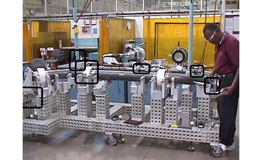

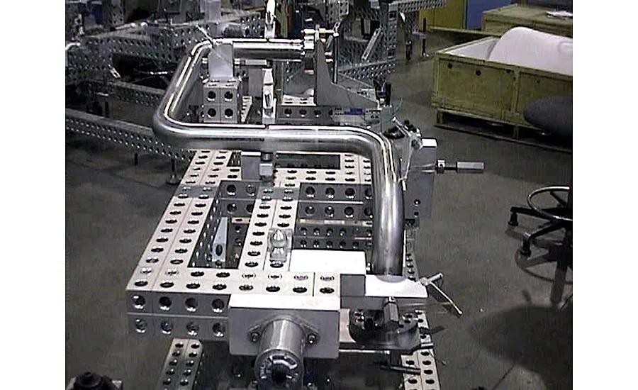

Enter a larger structural modular framing component and connection elements and a profile with a thicker wall of high tensile strength aluminum. Preferably, of the 7000 series material with a hard coat anodize surface throughout. This larger profile will afford best practice fixturing for those massive parts. For example, a fuel tank measuring large diameters in feet not inches. These tubular parts are often heavy metal structural forms of welded steel bodies maybe stainless. Imagine the twin tall exhaust “pipes” on either side of the cab or tanks mounted on board flatbed trailers hauling liquid on a 54’ rig. Materials vary. Molded heavy duty plastics containers (an updated material design feature to transport large capacity fuel or milk) enables considerable weight savings when loaded with less fuel consumption by the cab. On the smaller scale, think window washer fluid reservoir. The tubular, cylindrical or round part has always been a challenge for fixturing but with the right holding clamps and locating elements it’s a snap.
Presenting these parts to the CMM for inspection can and will be tricky. Unlike a small car door, fender, hood and more, all the cab, or body parts for exterior and interior in these large scale vehicles are checked with similar processes. New designs for this challenge and to accommodate change in design for workholding is a key reason to look to modular systems. Even the latest tech will bring electric vehicles (EV) to these big rig manufacturers. There has been a continuous drive (no pun intended) to roll with the necessary changes for massive batteries, storage and charging componentry. It’s inevitable that this technology is upon us and the freight vehicle makers are responding. The short haul and long haul requirements are growing and EV will be a major force for the local delivery trucking industry. Online shopping has been a target for these vehicles, especially over the last year with more shopping and delivery options during the global lockdowns.

As an example, a design fixture built for a rocket engine component was special but had many reusable modular tooling components. Next to zero waste. This complex tool was for a very large diameter tubular component. This manufacturer was also under the gun to build and change tooling to meet critical deadlines. The beauty was that the part (CAD) files were changing rapidly and the connecting tubular sections, with flange mounting assemblies, were also changing and not always in sync. This team was able to make adjustments on site by removing the special machined holding “nets,” make updates and easily replace with the simple locking and clamping devices.
