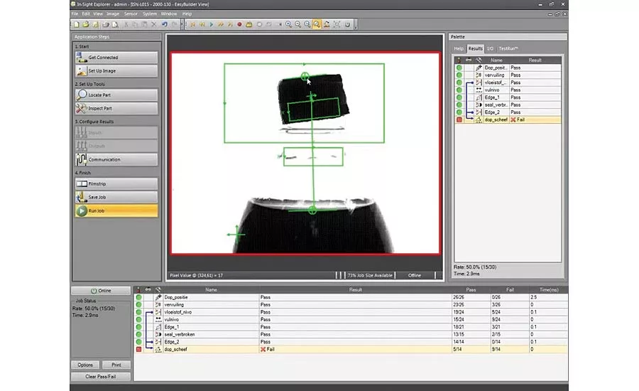

Intuitive interface used to set up vision sensors. Source: Cognex

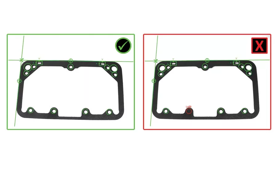

Vision sensor inspection of good gasket (left) and bad gasket (right). Source: Cognex

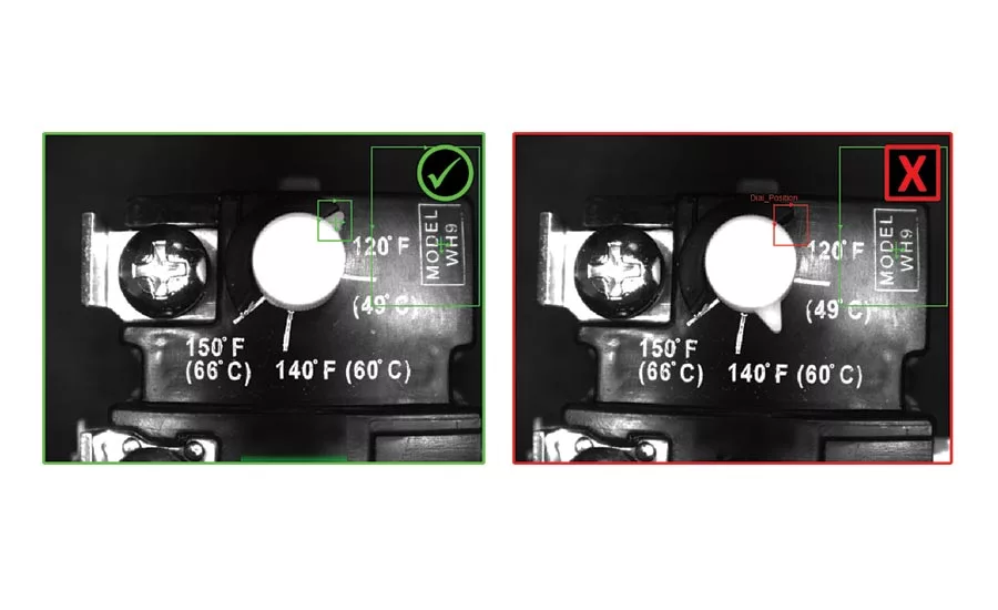

Vision sensor inspection of thermostat with dial set to correct position (left) and wrong position (right). Source: Cognex
Vision sensor inspection of properly filled bottle (left) and underfilled bottle (right). Source: Cognex

Here are a few examples of how vision sensors are being used to replace point sensors and to deliver new inspection capabilities. Gaskets are used extensively in automobile production to insure a tight seal between irregular mating surfaces. Because automation is used throughout the automotive assembly line, inspecting for a proper hole punch on these gaskets is critical to avoid upstream process issues. In this case, a fixture jig and 13 individual photoelectric sensors would be required to inspect the part. Here, a single vision sensor is used to inspect all 13 through holes at once. An edge intersect tool is used to locate the part, which eliminates the need to fix the part precisely in front of the camera. When the part is properly located, 13 individual pixel count tools are used to detect the presence of a through hole. Any missing hole will cause the part to fail.
In some applications, it is important that a dial be set to the right location to ensure proper installation or final product configuration. This is often difficult to accomplish with a traditional point sensor which is normally designed to check for the presence or absence of a component rather than subtle differences in its orientation. On the other hand, a vision sensor can easily inspect the dial on a thermostat to confirm that it is in the correct position—in this case set to the lowest temperature.
Proper filling is critical in many manufacturing applications. Using vision sensors throughout the production line identifies rejects before secondary or final packaging, saving money by avoiding adding additional value to a bad product. Unlike traditional point sensors, vision sensors can perform multiple inspections on each image. In another example, a bottle passes in front of the sensor and both fill level and cap assembly are validated before the product is packaged. The bottle is located using a pattern tool to find the cap, the fill level is inspected using a pixel count tool, and cap assembly is inspected with an edge tool.
