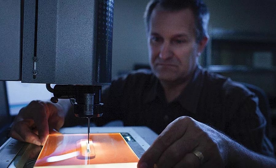

Dan Bukaty Jr. at the Starrett AV300 measuring a part.

“Intricate measurements were taken either by height gages on a granite surface plate, an optical comparator or even an autocollimator for measuring angles,” says Bukaty. “The process was very time-consuming, often required math calculation and the results were unreliable. We could not achieve the accuracy we needed.” On many optical parts, PG&O needed to move the work from one operation to another, measuring and re-measuring.
“We would capture height and width measurements from a height gage and then move the part to an autocollimator or interferometer,” says Greg Quinn, PG&O QA manager. “A part with tight tolerance angles could take hours to measure and yield either non-repeatable measurements or questionable accuracy.”
Amid all the uncertainty and time loss, PG&O serendipitously discovered the solution to its drag on quality. Pressed to inspect a complex rounded pyramidal part with four faces that needed to be accurate to 15 arc seconds, PG&O noticed that the measurement of this part which they sub-contracted to a third party vendor was being made on a Starrett AV300 Vision System. “We later inquired about this machine ourselves and bought one within a week,” says Bukaty.

The Starrett AV300 has enabled PG&O to verify production parts quickly. “With the AV300, many, if not all, attributes can be captured simultaneously, saving an enormous amount of time. The machine’s programming function allows us to insert the part, hit go and walk away. The accuracy is far superior to our previous inspection methods,” says Bukaty. “Honestly I don’t know how we got along without the AV300.”
“The pre-programming CNC feature is ideal for 100% inspection on a multiple quantity order of, say 150 pieces. Once the tolerances and features of the part are measured, recorded and stored on the first piece, measurement on the other 149 pieces can be automatically repeated,” explains Quinn. “We can also print out a professional looking report for verification and our customer’s documentation requirements—something not possible with a height gage or autocollimator.”
Versatility is another advantage with the Starrett AV300 system. “Similar to a CMM, the machine can measure parts via touch probe or optically by zooming in on an edge or artifact, aligning with the crosshair reticle and taking the measurement manually or automatically,” says Quinn. “The system is also very easy to use.”
The Starrett AV300 Automatic Vision System is as flexible as it is powerful, enabling quality assurance personnel, inspectors or machinists to achieve maximum throughput of finished, accurate parts in their manufacturing operation. The system’s performance is enhanced by an exceptionally stable mechanical design with precision linear bearings, in addition to high-resolution video zoom optics and touch probe, that all combine to ensure accurate 3-axis measurement.
Another throughput-enhancing feature is the system software which controls all video edge detection features and multiple channel fiber optic or LED illumination. The system has a travel of 12” x 6” x 5.5” (XYZ), which is ideal for PG&O, since most of its parts are 6” or under.
