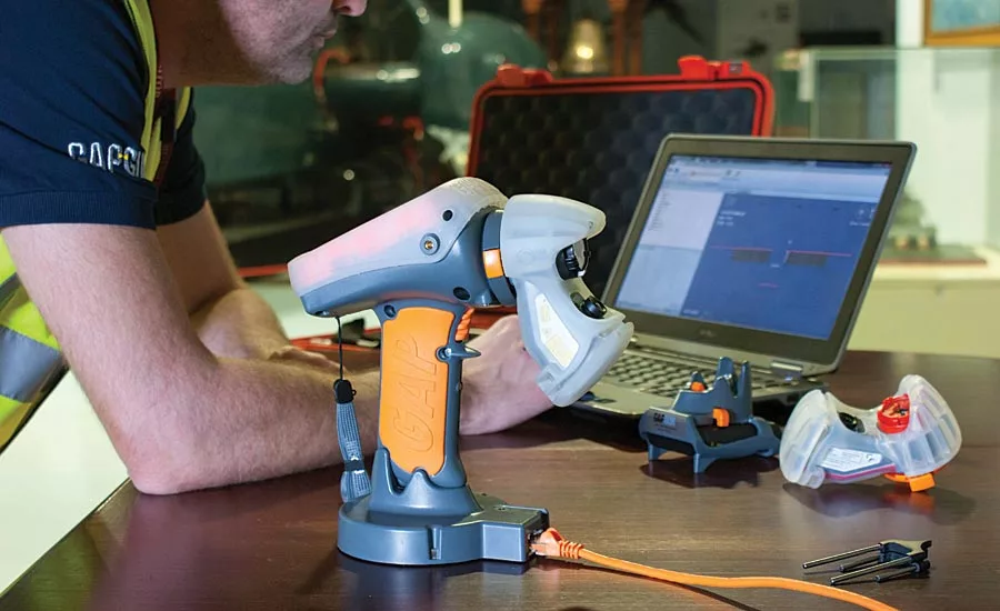

Optical metrology is the principle behind noncontact laser measurement devices that determines the dimensional profile of a part, by taking a series of pictures of its surface.
The speed and accuracy of noncontact laser measurement devices means every single car can be measured.
The key to profile measurement is to reliably report the surface in a lot of detail. Laser triangulation technology is used to collect measurements by projecting a laser stripe across the surface of a part to determine the measureable feature. Simultaneously, an integrated camera system takes images of this static laser stripe. As the angle is known between the camera and the laser projection, an algorithm can be written to calculate the dimensions of the surface over which the laser falls and the camera sees. This measured data is then output to point cloud format to generate a digital copy of the surface.
A point cloud is produced by software that uses image processing to convert the images of the profile into a series of points which can be used to extrapolate the shape of the feature. These points allow the system to analyze the measured surface. Because a laser is a clean form of structured light, measured data is highly reliable and can be used as a stable light source for data analysis.
Today’s noncontact laser measurement systems can scan a component’s profile to measure features that include angle, radius, edge break or scratch for example. Measured data is then recorded for statistical process control and traceability purposes and transferred to a computer, enabling the operator to rectify any mistakes in real time on the production line. This ensures components are the correct size and fit together accurately without compromising the quality, cost or time to complete the build.
Noncontact laser measurement devices offer a repeatable set of rules that do not require subjective interpretation, which means that manufacturers have the ability to measure lots of profiles and surface finishes quickly, repeatably and in well-defined ways.
