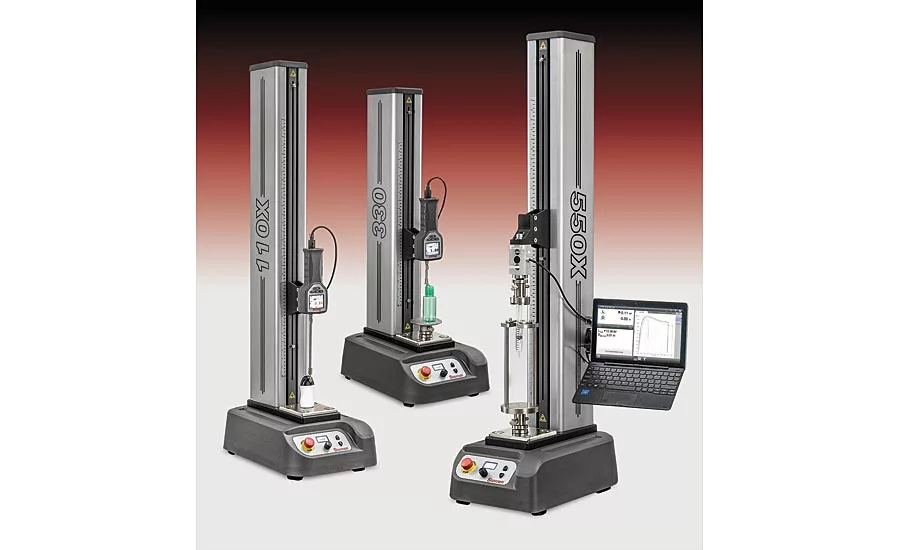

The L.S. Starrett Company has introduced a series of Motorized Digital Test Frames for performing a wide range of basic, high volume in-situ lean manufacturing force testing applications including tension, compression, flexural cyclic, shear and friction. The Starrett FMM Digital Force Testers are part of the new Starrett L1 Line of entry level computer-based force measurement solutions. Optimized for production and quality control testing, the versatile, innovative architecture of the L1 system is designed for fast, easy-to-use, reliable and repeatable operation.
Starrett FMM Force Testers can be used with either Starrett L1 software for computer-controlled testing, or with a Starrett DFC Digital Force Gage.  The DFC gage lets users control the speed and travel of the FMM Series, providing a single operator interface for control and testing. Using the DFC Series on an FMM test frame, load, distance and break limit testing can be performed simply at an economical price and with excellent accuracy of better than 0.1%
The Starrett L1 software offers simple, fill-in-the-blank templates that let users create, perform, measure and analyze their test in seconds and perform limit testing, break testing, constant hold testing, cycle testing and more. Touch screen control simplifies operation and the high resolution display shows results in tabular and graphical formats. Tolerances can be applied for immediate pass/ fail indication. Raw data can be exported to Excel for reporting and statistical analysis.
Starrett FMM Series Test Frames are available in three force capacities: 110lbf, 330lbf and 550lbf (500N, 1500N and 2500N), and are furnished in a standard travel length (20-inches/ 508mm) or an extended travel length (30-inches/ 760mm). FMM test frames feature a small footprint for small work spaces. The frames are just 11 inches wide by 16 inches deep. All frames have a speed range from 0.02 to 40 inches per minute (1 to 1000 mm/ min). Position accuracy on the FMM test frames is better than 20 microns and speed accuracy is better than 0.1% at full load and at maximum speed. Jog keys and an LED display aide manual operation. Adjustable travel limits may be used to prevent over-travel conditions.
The FMM test frames also feature an adjustable base plate made of cast aluminum for exceptional rigidity and durability. Inspectors may use metric or imperial threaded test fixtures and clevis adapters. The base plate is adjustable so that sample alignment can be performed in seconds without special tools.
