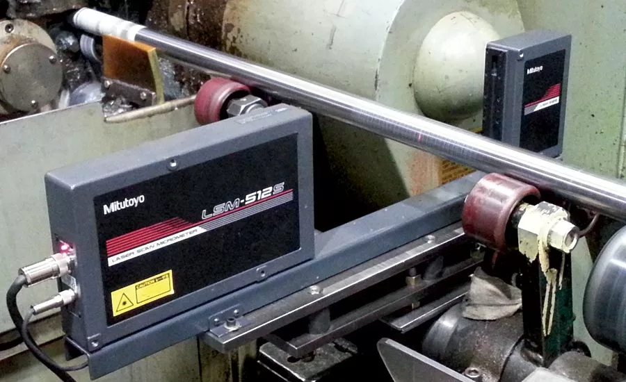

Laser scan micrometer measuring diameter immediately after finish grind operation.

Laser scan micrometers with part detection and automatic run execution can detect and measure the part and then send the data directly to a PLC. The PLC (or other device) monitors the measured diameter and makes adjustment when a limit is reached. (The limit having been set by an engineer and derived from statistical process control methods.)
