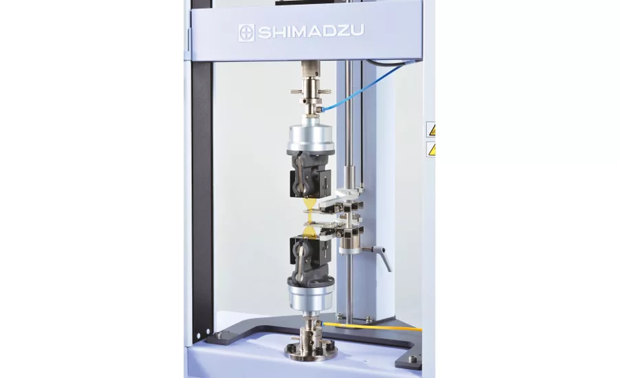

The importance of these tests is related to material characterization, examination of function, and quality control. The testing process examines several factors related to material performance, including residual elongation of a sample after being stretched and allowed to relax as specified. The amount of time for stretching and recovery are specified by the ASTM D412. In addition, specimen preparation, test equipment, and conditions are all outlined in the standard.
As for the ISO 37 standard, according to ISO, “This document specifies a method for the determination of the tensile stress-strain properties of vulcanized and thermoplastic rubbers. The properties which can be determined are tensile strength, elongation at break, stress at a given elongation, elongation at a given stress, stress at yield and elongation at yield.”
While the test methods are critical, so are the machines. Evaluating the additives that are used in polymer materials requires the right tools for the application. A universal testing machine is the instrument of choice for the ASTM D412 standard, and accessories may be added as needed. Extensometers may be also used to improve measurement results.
Reporting calculations in compliance with the standard is one challenge of testing to the ASTM standard. This can often be addressed with the appropriate software. Other important considerations to keep in mind during testing are specimen alignment and a secure grip.
