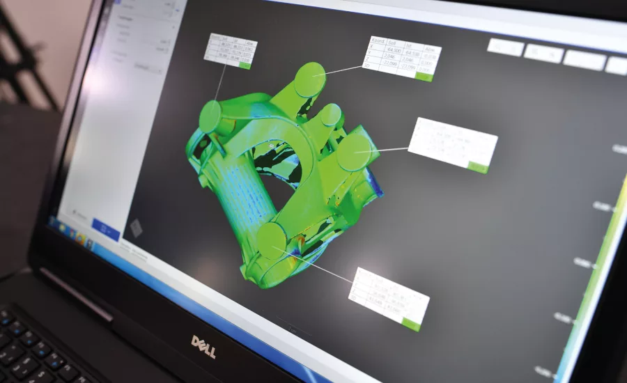

One of the biggest learning curves relates to software, Scribner says. “It’s a misnomer that when people 3D scan a part the scanner itself creates close to a watertight STL that can be used for reverse engineering. Basically you have to get a reverse engineering software to get the STL file.”
When customers see the information inside the scan software, they often think there are no additional steps. “A lot of times it’s not just about the hardware component of 3D scanning. Hardware is only half the story,” he says. “You really have to get the correct software, the right software for doing what you need to do.”
