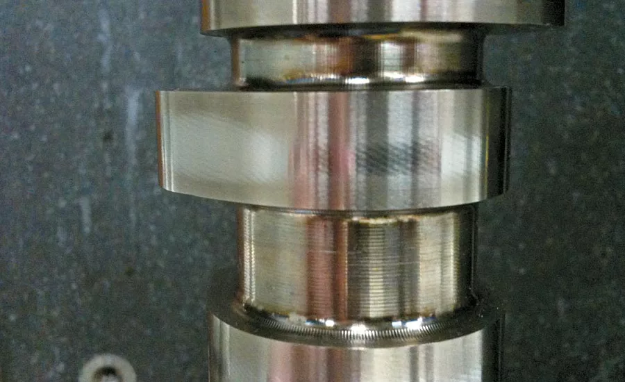

Here are examples of chatter marks (a.k.a. chatter).

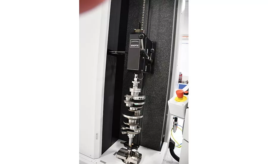

Part loaded between upper and lower centers
Shaftscan

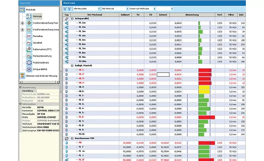

Measurement tracking software
The software facilitates measurement tracking on the screen. In addition to the numerical output of measured values, the warning limits are also displayed; these are shown in color to improve clarity.

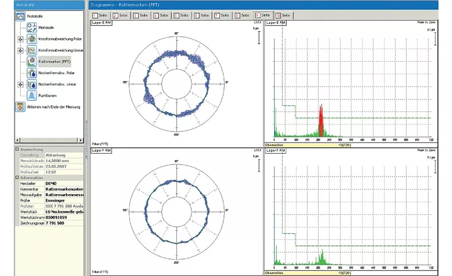

Chattermark evaluation
Chattermark evaluation of a workpiece with and without (upper) air bearing mechanics. Without air bearing mechanics, several tone bursts were recorded that originate not from chattermarks but from the measuring system itself. The existence of chattermarks can therefore not be reliably determined with this type of system.

Unlike lobing, which is based on deviation in an angular window, chatter analysis is performed using a fast Fourier transform (FFT) to analyze the roundness data. This algorithm samples the data and divides it into its frequency components, each with its own amplitude and phase. The chatter measurements are shown as undulations per revolution (UPR) and plotted with their corresponding amplitudes.
Chattermarks on precision shafts, even at low amplitudes, can shorten the life of the bearing. On camshaft lobes the presence of chatter is more of a concern for NVH (noise, vibration, and harshness) than durability.
When measuring either lobing or chatter, attention must be given to choosing a filtering method. The automotive and aerospace industries have long employed filters of 5, 15, 50, 150, and 500 UPR as the standard options and care must be taken to ensure that the frequencies of interest are not removed or attenuated. High UPR cut-off filters are commonly used in lobing measurement, but it is preferable to use no filter on FFT/chatter measurement.
Even with low frequency, long wavelength undulations, using a Fast Fourier Transform (FFT) is a more useful approach if the goal is to isolate a problem frequency and locate the root cause. Isolating the frequencies that make up the total roundness error also allows us to apply tighter tolerances to specific UPR ranges. On a crankshaft bearing or journal, these tolerances will typically get tighter as the UPR frequencies increase. In other words, deviations that occur over a longer wavelength are less of a durability concern than those occurring over a shorter wavelength. If the manufacturing process produces a frequency that is typical, we can also apply a control tolerance to a specific frequency.

Chatter marks were traditionally identified by manually inspecting the ground surfaces under intense light. While this can be an acceptable method of inspection for chatter produced during milling or turning operations, it is generally not acceptable to find chatter produced during grinding. Visual inspection, either by human or machine vision, is inadequate for quality control on grinding operations because the frequency and depth of the defects cannot be quantified. Manual inspection is also fatiguing to the inspector and so, unreliable as a long-term solution.
