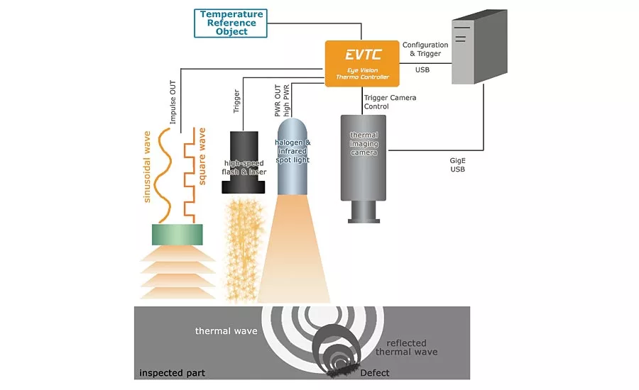

Controlled Heating with a Thermal Controller
A thermal controller makes it possible to realize not only passive but also the different active thermal imaging applications with almost any thermal imaging camera. This means impulse as well as lockin thermal imaging.
For the passive method the thermal controller can control reference objects. This means it compares the temperature of the reference object and determines if the process temperatures of the materials, which emerge from the process, have the expected temperature. If they don’t and the material has not the temperature of the reference object, then the software can issue an alarm or warning or the faulty product can be immediately rejected via communication with the machine. To achieve that a simple inspection program in the software and a communication protocol such as Profinet, Modbus, Ethercat, Ethernet, etc. are necessary to communicate with the machine.
For the impulse thermal imaging the controller takes over the control of the heat source. The thermal controller can have different control outputs to control either flash, infrared light, or halogen light and to initialize the image capture at a defined moment.
PCB board
A PCB board captured with a thermal imaging camera (active thermal imaging).
For the real lockin thermal imaging are sinusoidal heat sources as well as rectangle heat sources available. As the thermal controller takes over the heat stimulation, it also controls the image capture process either via a protocol or via an integrated trigger input and output for the direct control of the camera. But only a few cameras have such control possibilities.

1. Active heat flow thermal imaging
In case of the active heat flow thermal imaging the surface of the object is heated with a heat source. This heating does not have to be very strong. A few tenth of degree Celsius are sufficient, for example with an infrared light or UV-light or ultrasound. After that the heat goes from the surface into the inside of the object. If an error with a different heat conductivity is under the surface, the heat dissipation is affected. This means that the surface stays longer warm. The thermal imaging camera can capture those hot areas and detects errors such as holes and voids.

1.2. Impulse thermal imaging
The impulse thermal imaging is similar to the lockin thermal imaging because it is also a procedure of the active heat flow thermal imaging. But the impulse thermal imaging only needs the heat source for a short time. The surface of the object is heated with flashes for only a millisecond for a few degrees (less than 5°C). In many cases the impulse thermal imaging leads to a fast, qualitative error detection. Especially for strongly homogeneous inspection object the impulse thermal imaging is a good choice.
