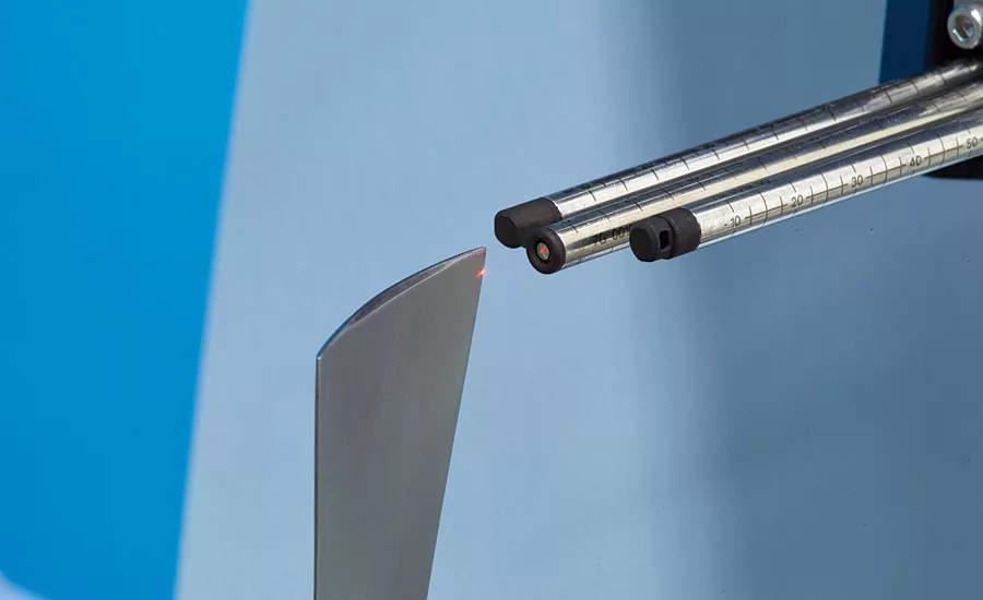

Hexagon’s GLOBAL S HTA Platform is based on the advanced HP-O sensor technology that places high speed measurement of aero- and land-based turbine blades in a shop floor environment.
