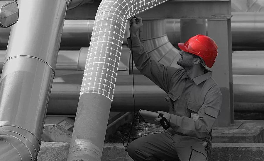

In addition to the move toward Industry 4.0, Rostkowski is seeing manufacturers integrate robots and drones to overcome rope access or scaffolding limitations. They’re also mounting stationary sensors under insulation to monitor assets without having to remove insulation, he says.
