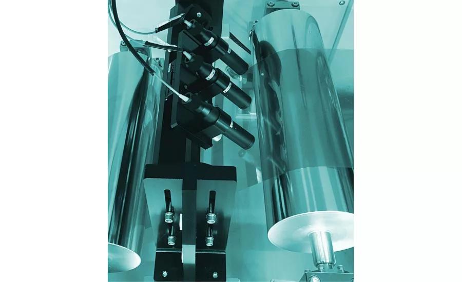

Chromatic confocal point sensors are widely used as direct imaging profilometers for surface texture analysis, dimensioning and tolerancing, and height measurement. These sensors are made up of a polychromatic source, optics that disperse this white light, and a confocal arrangement. When the dispersed wavelengths are projected and subsequently reflected from a measurement work piece, a single in focus wavelength returns to be decoded for distance via its confocal arrangement. If visibly transparent materials are being inspected, however, two confocal peaks are returned. The separation of these peaks corresponds to the optical thickness of the sample, which can be used in conjunction with knowledge of the material’s optical properties to determine a physical thickness. This one-sided noncontact thickness measurement technology is a key advantage for in-line thickness control of roll to roll processes.
In a roll to roll process, material undergoes a series of steps for the creation of electronic devices on flexible plastic substrate. One of these substrates is a transparent PET composite. Since the substrate is part of the electrical device, its thickness must be well controlled. By measuring the substrate thickness as it’s being manufactured, costly value-added processes on defective material can be avoided. A one-sided thickness measurement solution has many advantages for such an application. Some of these advantages are:
  • Reduced complexity of sensor placement – probes can be positioned at their working distance above the web without the mounting concerns associated with a paired probe.
  • Ability to log data automatically allowing for real-time statistical process control.
  • Absence of individual sensor drift (present in dual sensor arrangements).
  • Sensor spot alignment not required. In order to accurately report substrate thickness with a paired arrangement, both sensors would need to be aligned both horizontally and orthogonally. One-side approaches eliminate the need for this.
  • Absence of paired sensor acquisition synchronization. In order to accurately report substrate thickness with a paired arrangement both sensors would necessarily have to be measuring at the same location at the same time.
