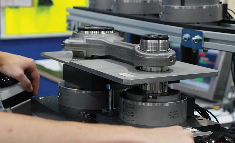

Air gaging is typically more application-specific than general-purpose solutions like a CMM. However, one of its core strengths is the interchangeability, or adjustability, of different components, allowing a much greater range of flexibility than it would otherwise be capable of achieving. A good example of this would be a system designed to measure connecting rods. Using a simple length adjustment block, the center-to-center distance between the pin and crank diameters can be modified, allowing a much greater range of sizes to be measured. Combine this with interchangeable air tooling and you get a highly flexible machine capable of measuring a much greater range of part sizes.
